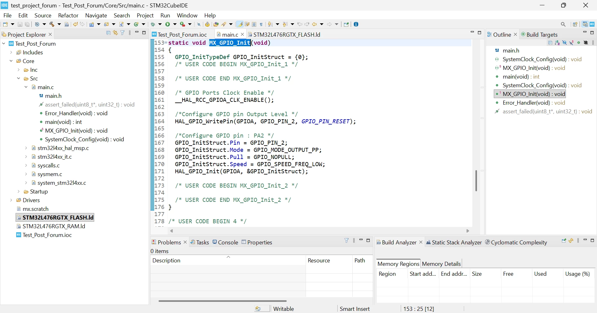

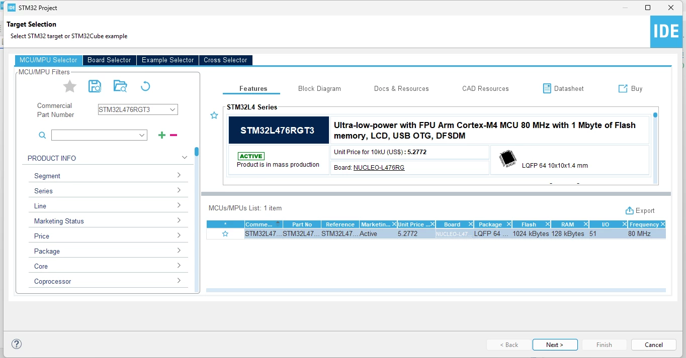

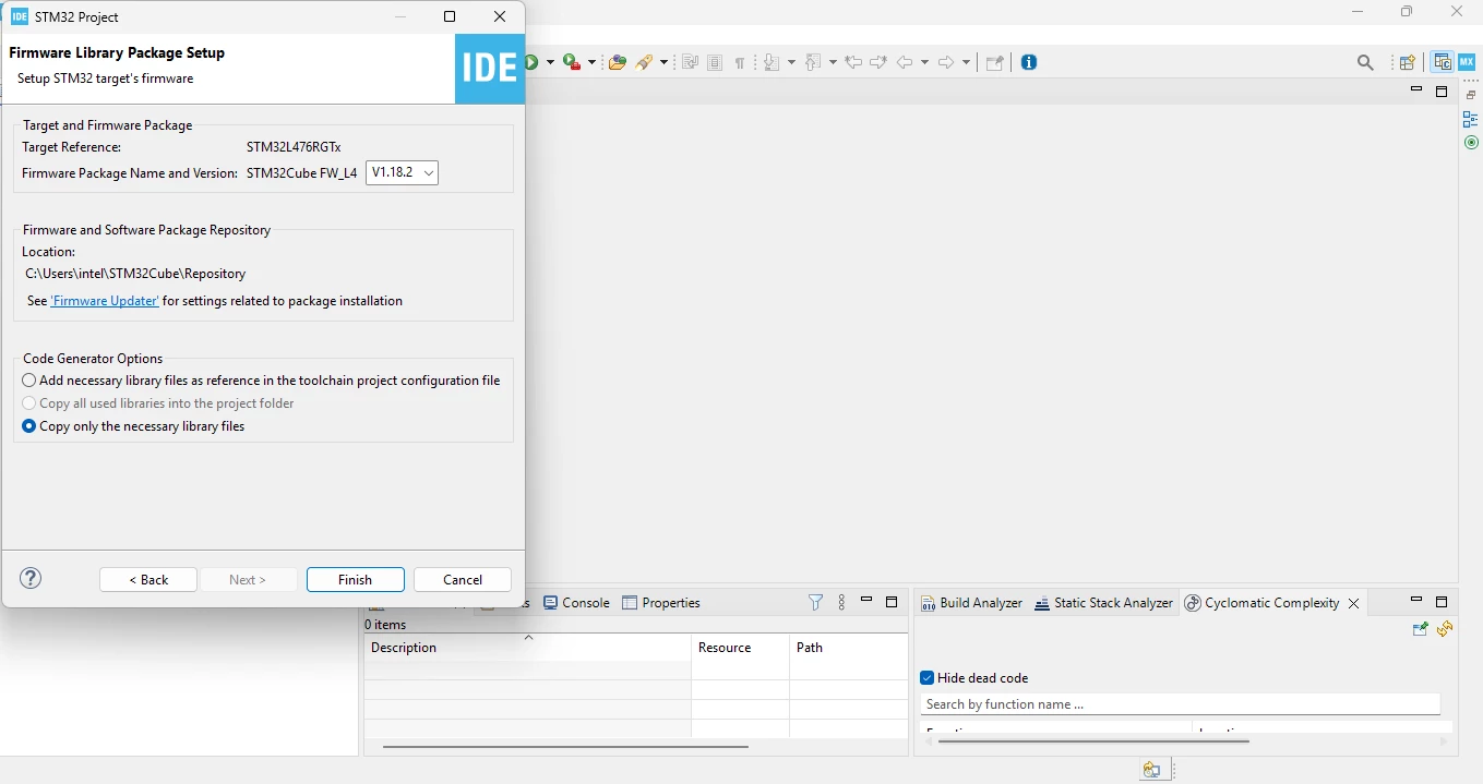

In STM32 Cube IDE code is not generated for whatever board I select.

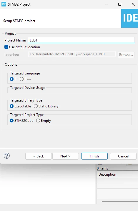

I am following these steps :-
Create STM32 Project
File → New → STM32 Project
Select STM32L476RGTx (LQFP64) MCU/board → Next → Finish
Open the .ioc file

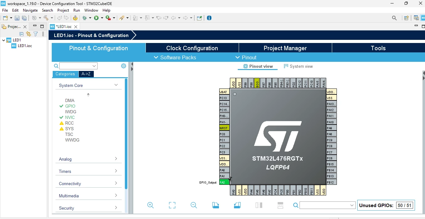

Configure LED1
In Pinout & Configuration,
Set PA2 to GPIO_Output, then click on project → generate code ( The ‘main.c’ file is not generate for given MCU and also for other MCU for similar steps code is not generating).

I was not able to reproduce the behavior described while using STM32CubeIDE 1.19.
The project was well created and generated with STM32L476RGTx.
I recommend that you check your network connection and install the relevant firmware before generating the code.

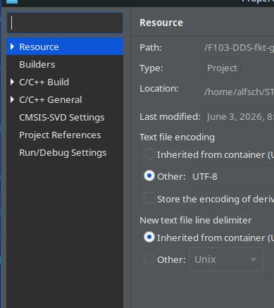

Aug 13, 2026 8:08 AM UTC

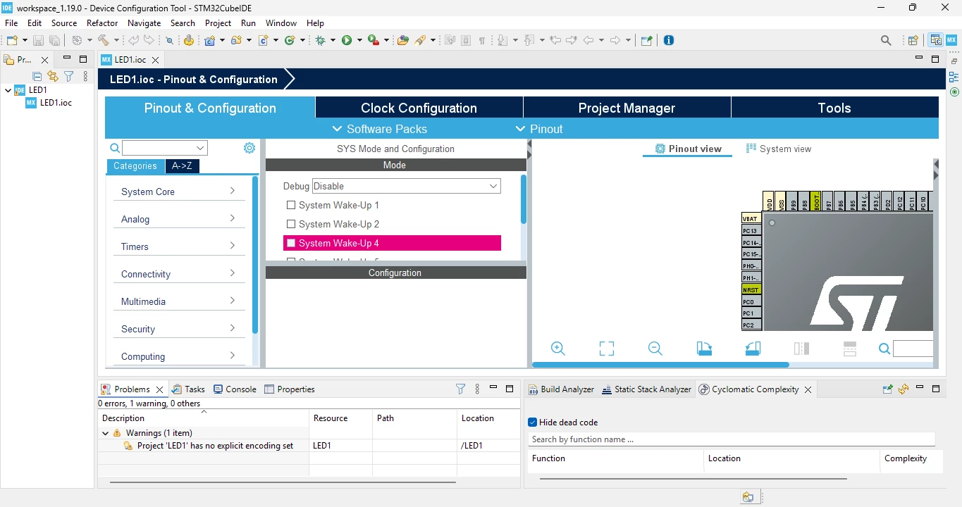

you have a warning:
check in project - > properties  - > resource … UTF-8

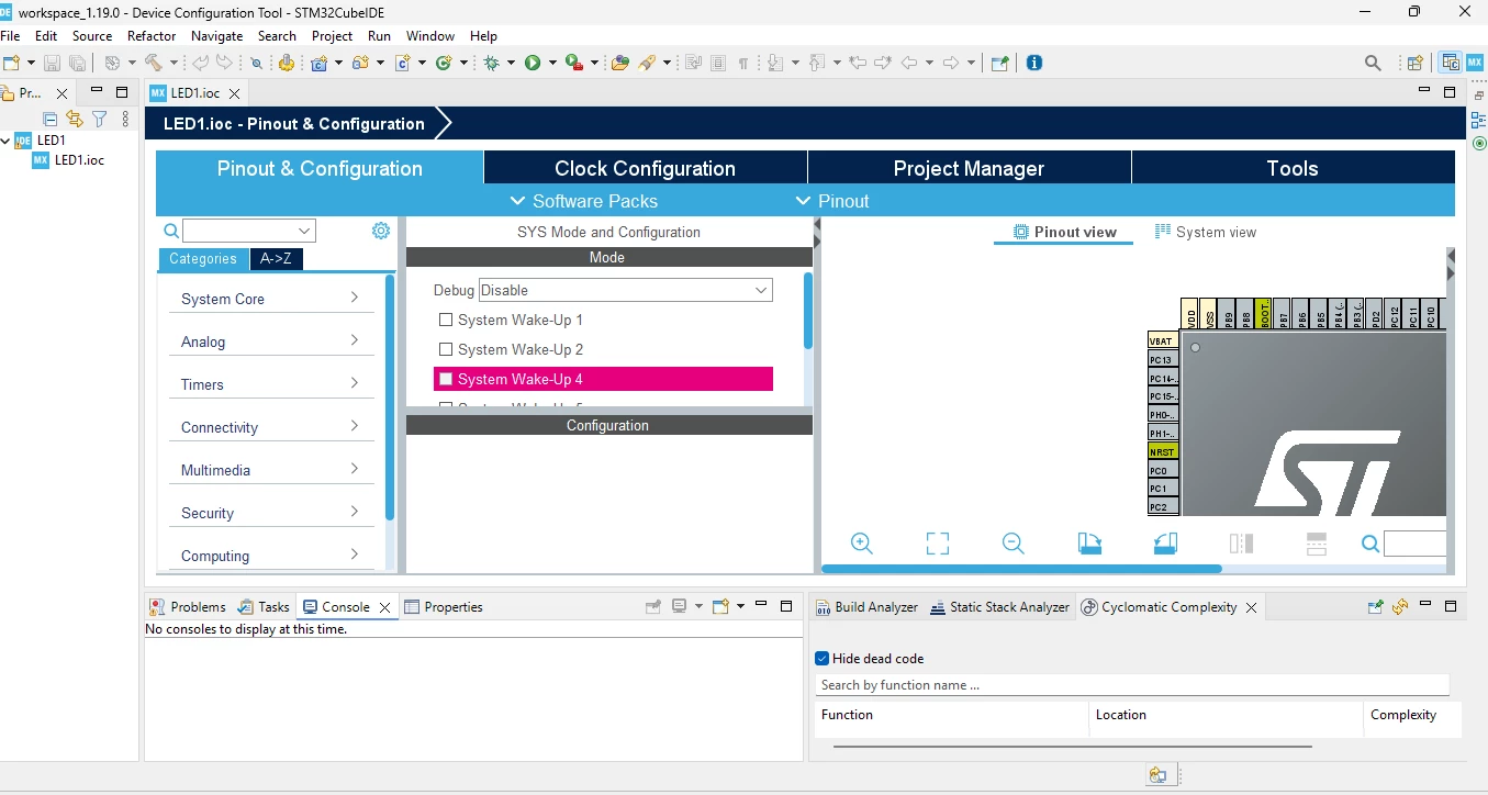

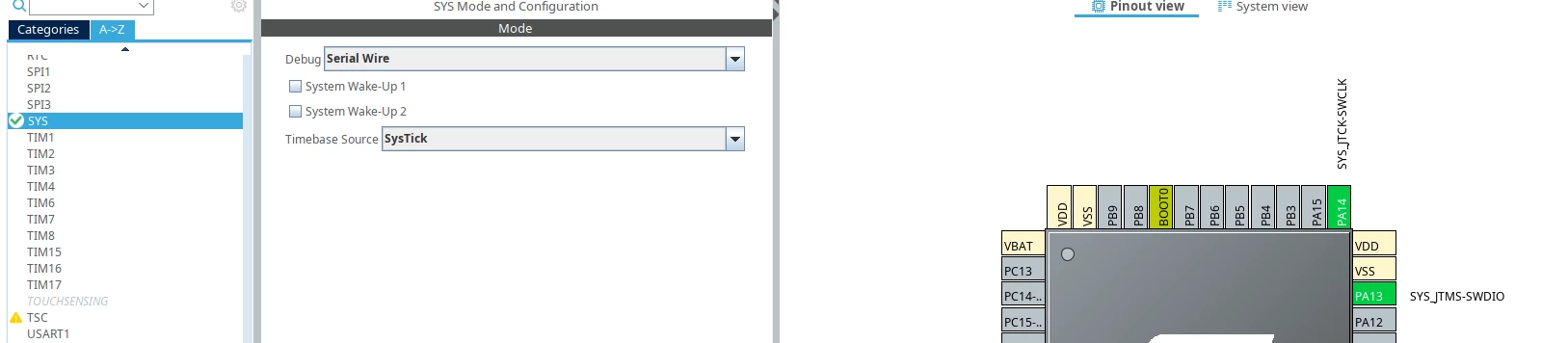

and have the swd debug set :
  • here on F303 , SYS,  on other cpu debug setting might be under : debug, etc.
maybe it cannot download cpu database , because you have to be logged in :
log in in menu - > Help - > stmCube updates - > connection to st

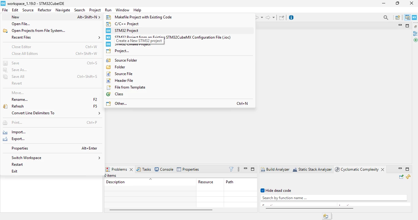

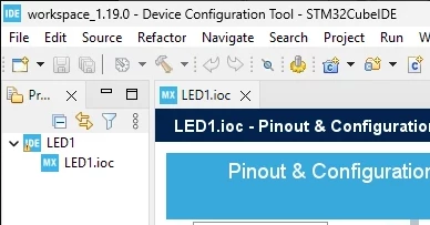

As ​@Mahmoud Ben Romdhane said, you need to say what CubeIDE version you are using:
If you are using v2.0.0 or later, you need to follow the new workflow:

Aug 13, 2026 8:53 AM UTC
seems 1.19.0 , internal Mx editor :

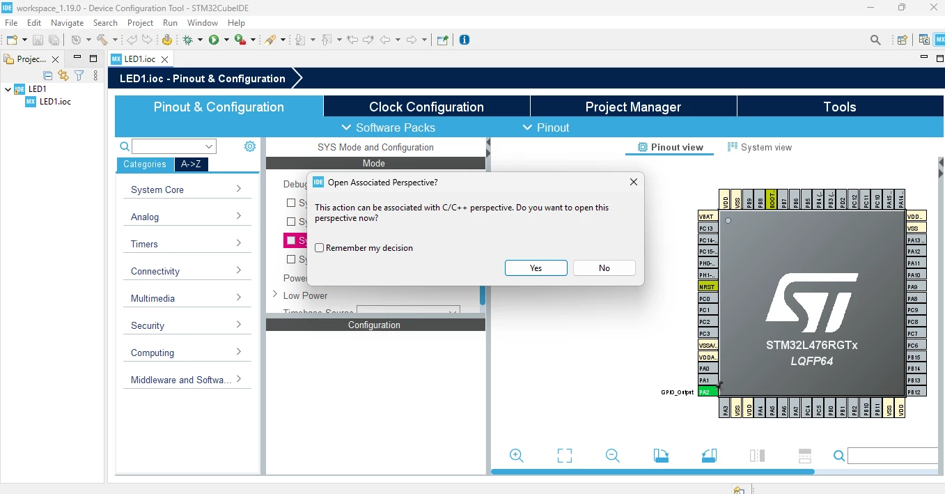

Aug 14, 2026 9:17 AM UTC
Thanks, I can able to resolve my issue now.
