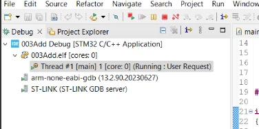

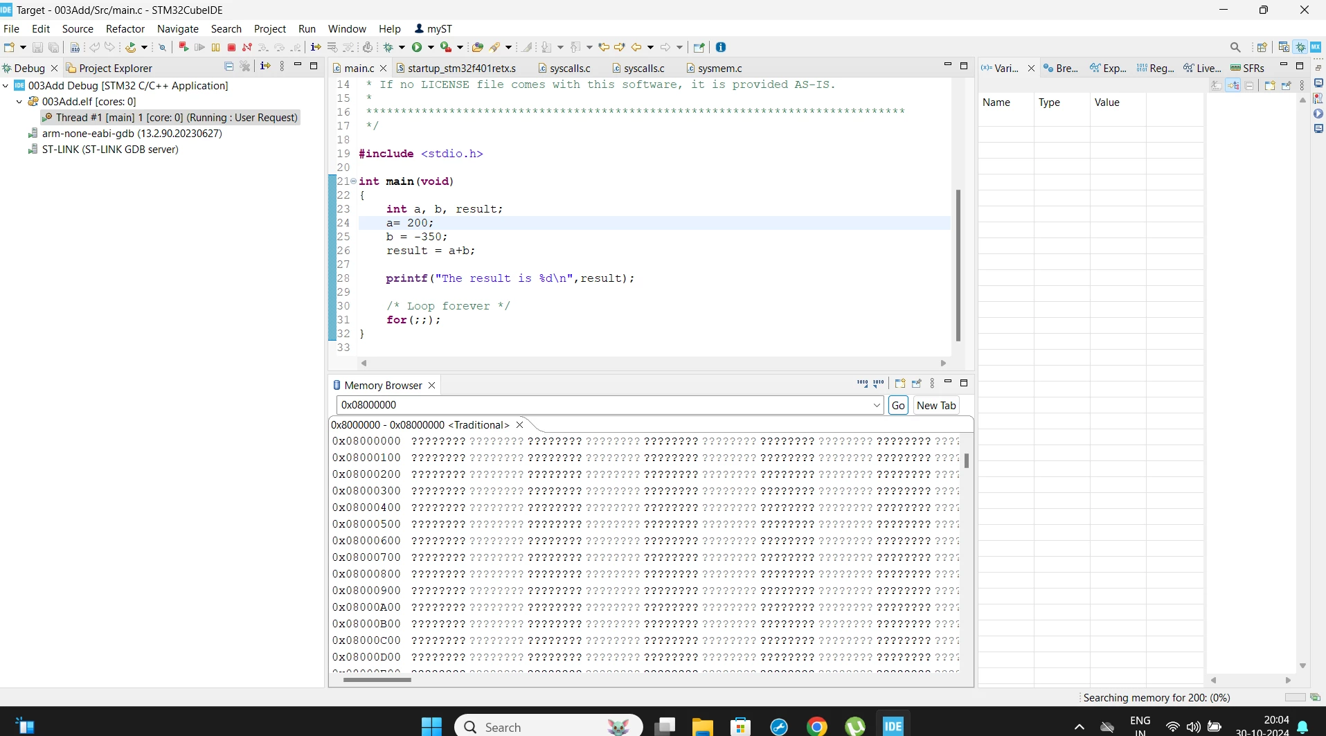

In Memory Browser all I see is ?????? for STM32F401RE
I was performing simple arithmetic calculation, and wanted to check the data gets stored in Flash and SRAM memory.
While checking the memory browser all I see is ?????. Could anyone guide me, what's the issue here?Memory Browser.png

You have to halt for it to update ?

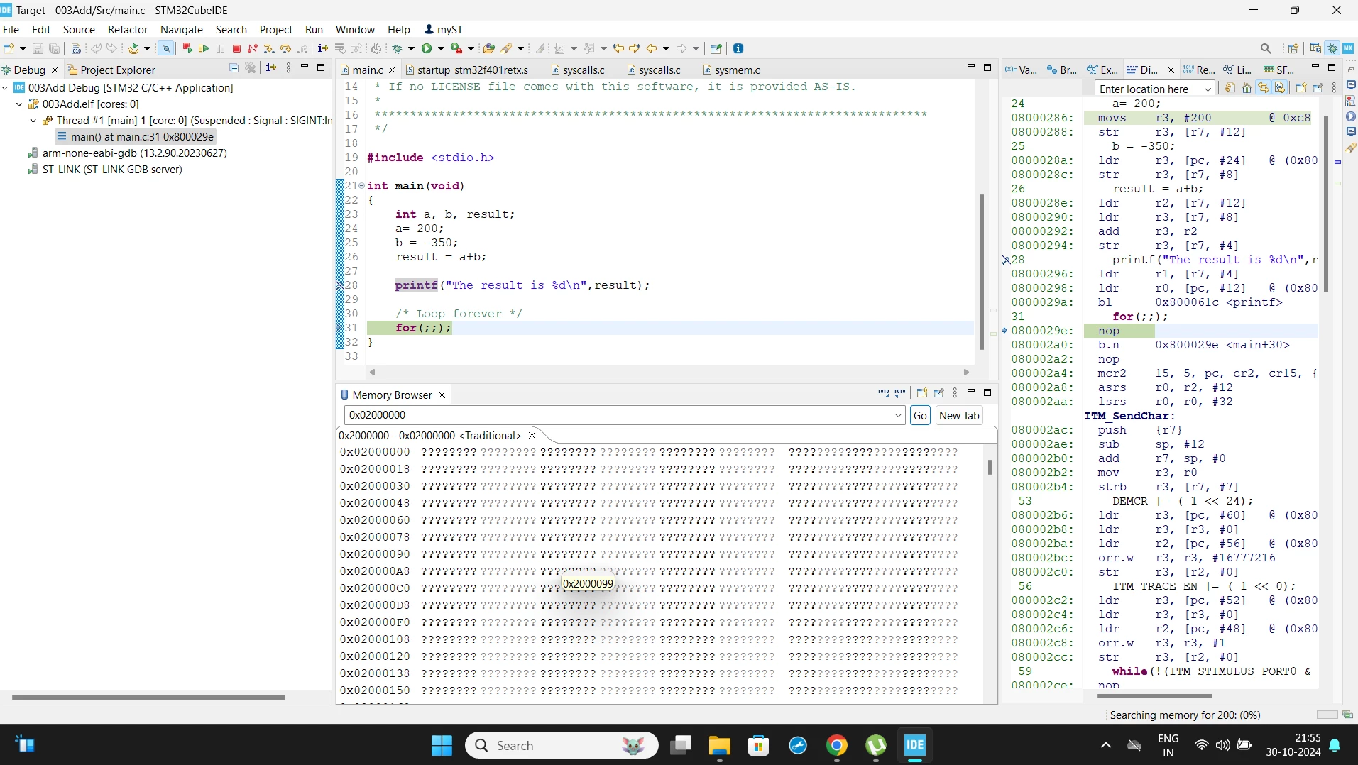

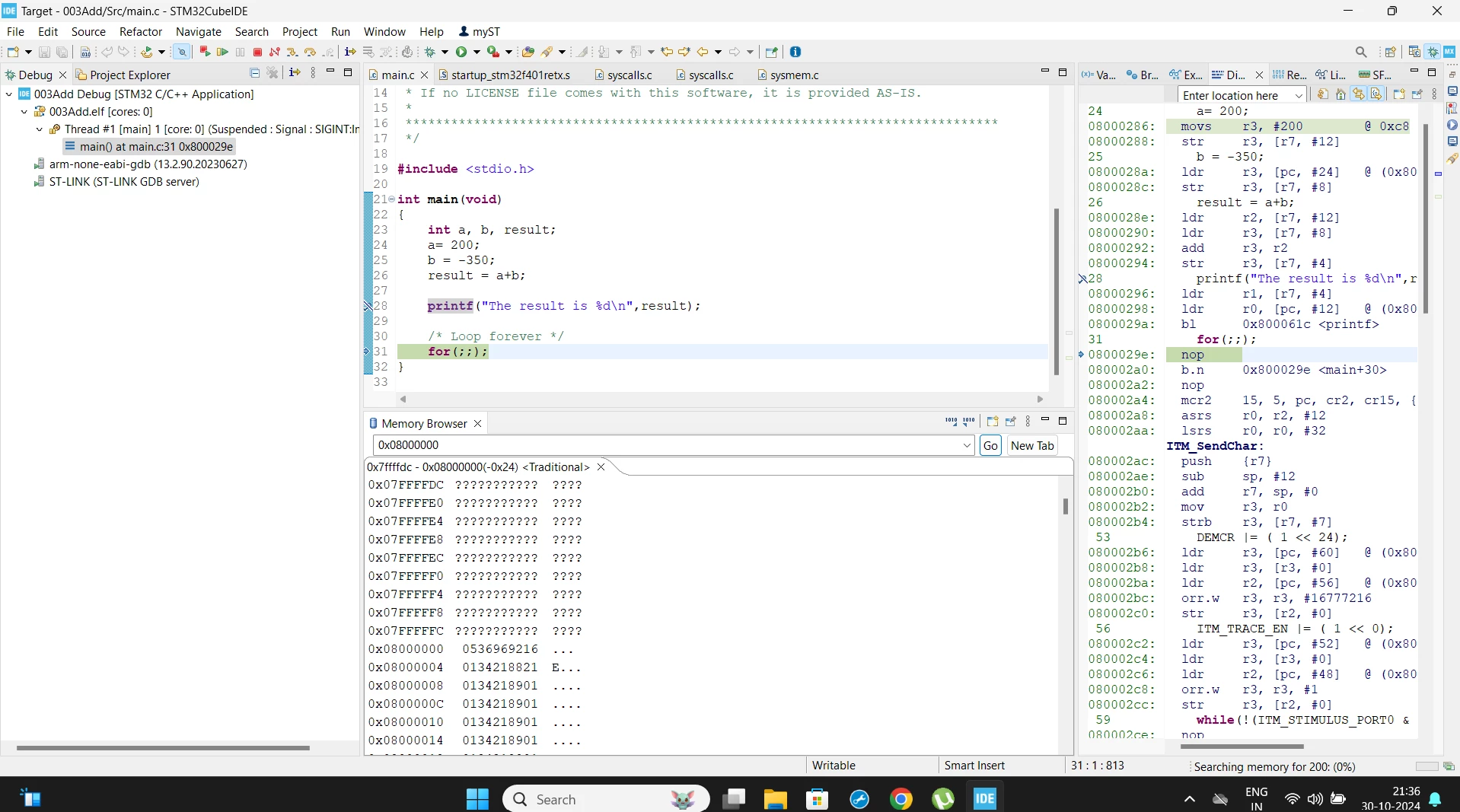

While suspending, it shows opcodes at 0x08000000, which is starting memory address for flash, but if you look at the screenshot, still it shows ??? mark at other various memory address.
Also, for SRAM memory, it shows the same.

And your in run mode again - so it cannot show ram data; only while cpu halted.
