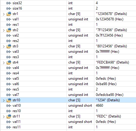

In CubeIDE, Can scanf() read an 8 character hexadecimal value, or is this a known bug?
When I attempt to read an 8 character hexadecimal value with sscanf(), I get 0x7FFFFFFF for all values over "80000000". It's as if sscanf() is confusing signed and unsigned numbers. If I read the 8 characters as two sets of 4, there is no problem (this is my workaround). If I try this scaled down to 16 bits, there is no problem. If I put this same code in visual studio (with sscanf deprecation disabled), there is no problem. I'm just using "include <stdio.h>" to get sscanf() as it ships with CubeIDE.
The attached code snippet is for illustration. It only take lines 13-15 or 19-21 to recreate the problem.
int size32=sizeof(unsigned int);	//just to verify data sizes
 int size16=sizeof(unsigned short);	//just to verify data sizes
 //need to read in 8 characters as a 32 bit hex value
 char str1[]="12345678";
 unsigned int val1;
 int res1=sscanf(str1,"%8X",&val1);
 char str2[]="7F123456";
 unsigned int val2;
 int res2=sscanf(str2,"%8X",&val2);
 char str3[]="80123456";
 unsigned int val3;
 int res3=sscanf(str3,"%8X",&val3);
 //val3 should be 0x80123456, but sscanf returns 0x7FFFFFFF
 //THIS is the issue of this post
 char str4[]="FEDCBA98";
 unsigned int val4;
 int res4=sscanf(str4,"%8X",&val4);
 //val4 should be 0xFEDCBA98, but sscanf returns 0x7FFFFFFF
 unsigned int val5,val6;
 int res5=sscanf(str4,"%4X%4X",&val5,&val6);
 unsigned int val7=(val5<<16)+val6;
 //scanned as separate 4+4 chars instead of 8, no problem
 //trying the same thing scaled down to 16 bits
 char str10[]="1234";
 unsigned short val10;
 int res10=sscanf(str10,"%4hX",&val10);
 char str11[]="FEDC";
 unsigned short val11;
 int res11=sscanf(str11,"%4hX",&val11);

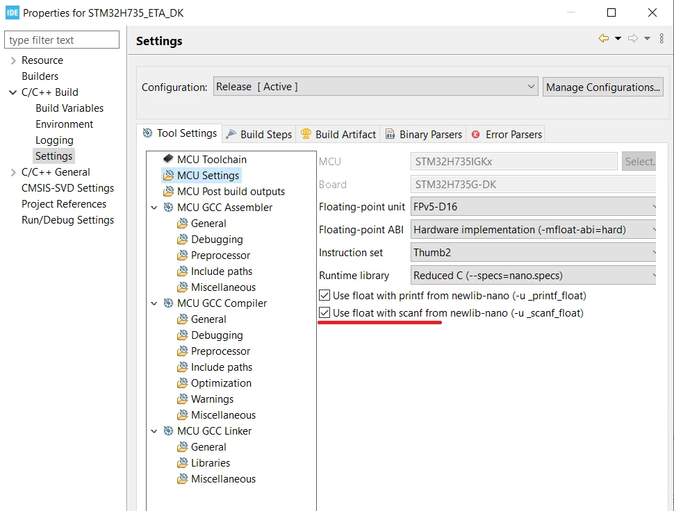

1st thing: try "%lX" in sscanf to read a 32 bit variable.
Next, try activating the float option in CubeIDE project settings, but I don't know if there's a connection between float and 32 bit integers with this option.

Maybe the "use float" also affects other 32 bit variables for scanf?

OK. Great. Lowe Case 'x' works fine but not Upper Case 'X".
We also played with the "Runtime library" setting above. With the "Reduced C" option, lower case x works, upper case X caps out at 0x7FFFFFFF, and 64 bit sscanf doesn't work at all ("%8llx" or "%llx").
With "Standard C" selected, Everything works correctly regardless of case or log or long long.
Who Knew?
I will use the lower case 'x' solution.

waclawek.jan
April 5, 2023
I believe this is an unintended "mild bug":
number:
scan_data.code = (c < 'o') ? CT_INT : CT_UINT;
The intention of this line is to elegantly separate those format characters out of the "number-specific" characters (pxXduio) which are signed - basically d and i - and unintentionally it included X too.
I'm not interested in <stdio.h> and not going to report it to the newlib crew, feel free to do that whoever feels like it.
[EDIT] And here's the culprit https://sourceware.org/git/?p=newlib-cygwin.git;a=commitdiff;h=7c9651e3ccea4f8bbc5fe50d0ed266f8976a3328
