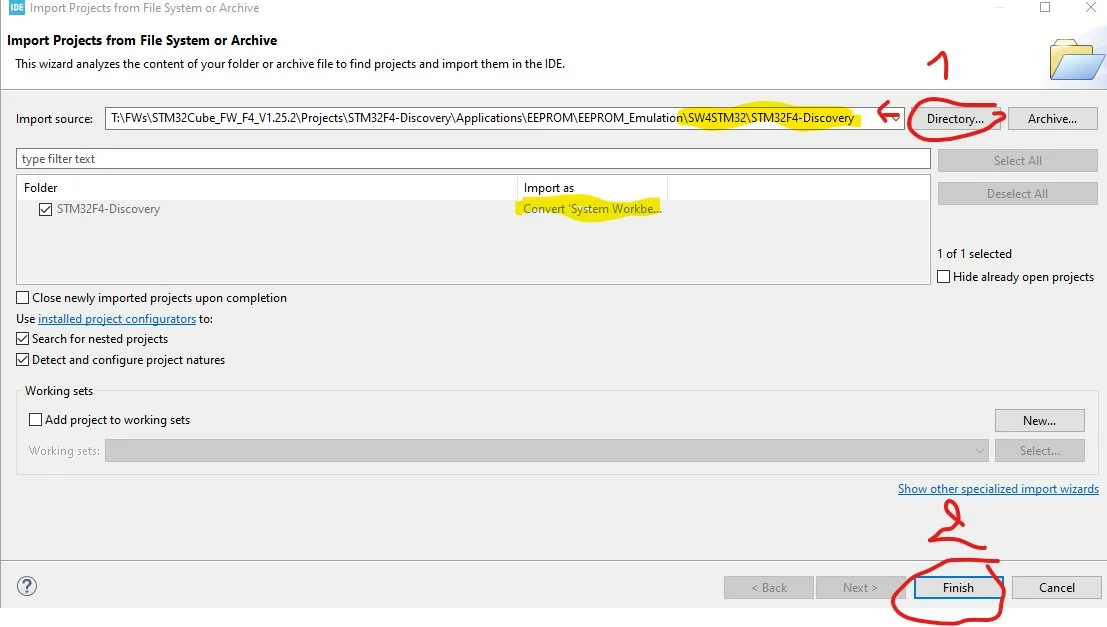

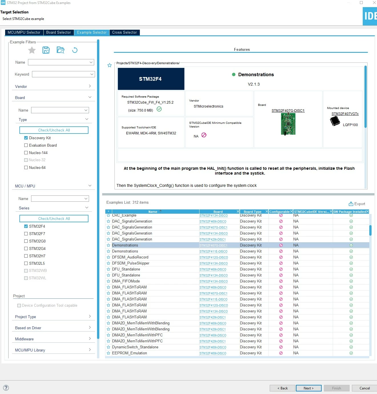

1) If luckily your example is part of integrated ones (sounds work in progress here release after release) example import can be done relying on example selector
Let's try this way: File> Import > General > Import STM32Cube Example
2) If your example is not available let's try : File > Open Project From File System
Helping you by the end takes care to promote path in sync with following highlight (i.e. include folder under SW4STM32 repository)

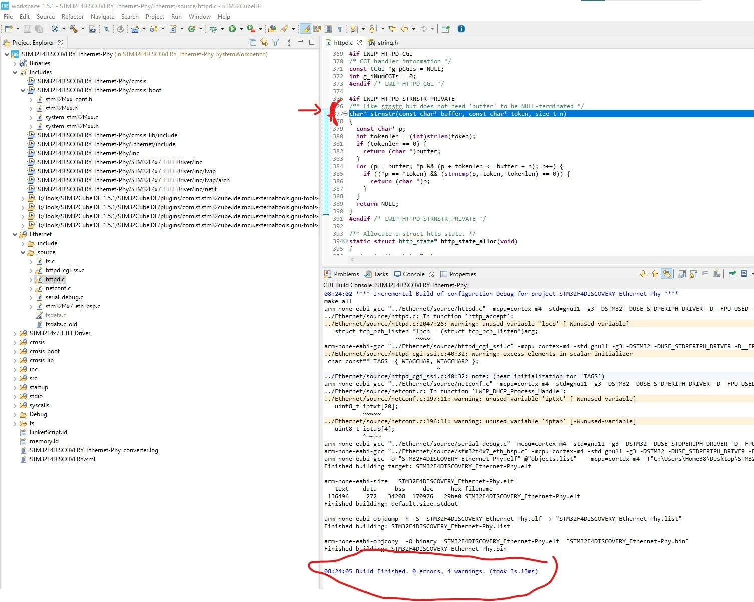

Thanks. I tried that but didn't work. So I switched to System Workbench and got it loaded. Unfortunately, the example had faulty code and produced many compile errors. I used an Ethernet example here: http://blog.tkjelectronics.dk/2012/08/ethernet-on-stm32f4discovery-using-external-phy/

Works like a charm on my side if doing a small patch to such example code source (not STM one by the way ...):
0693W000007CygxQAC.jpgI've just done File>Open Project From File System then removed 'static' as part of highlighted line if snapshot. If not compiler is complaining your prototype is not in sync. with function implementation what's a good warning ...
