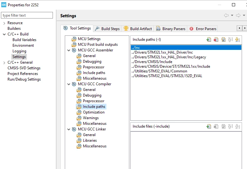

This is the project properties > c/c++ build> include path.
For this project i can compile without error but more warnings are there.

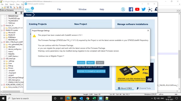

i installed the STM32cubeMX of latest version 6.1.1 after installing i am trying to load the client shared project 2252(i mentioned earlier) it is giving the warning like this.
Means the code/project generated with tool cube mx version of 4.15.1 and firmware package (STM32cubeFW-L1 V1.5.0).
i am trying to find Cube Mx version 4.15.1 , but i am not able to get that much older version of tool.
Please suggest me any link for that version of tool??
is there any possibility to check without that version??
any other version equivalent for this???
Please help me for this...

4.15.1 ... ouch ! so old tool release !
What may explain maybe why you're getting some trouble if STM32CubeIDE ... STM32CubeIDE 1.0.0 is relying on STM32CubeMX integration starting 5.2.0 release. I guess ST is supporting any legacy release but not sure such has been validated if so old release ...
According your STM32CubeMX snapshot sounds STM32CubeMX is still able to support your old material ("Continue" button aim) but I would myself kindly advice you to "Migrate" to most up to date tool suite (MX 6.1.1 & IDE 1.5.1) what may solve large part of your issues ...
Note: just in case keep a clone of your current project being safe but please try updating all such
