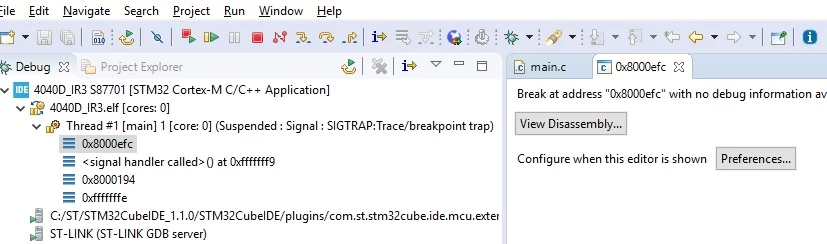

Below from the debugger console.
Why is there a reference to the following addresses?
Read 4 bytes @ address 0x08000EFC (Data = 0x0F04F01E)
Read 2 bytes @ address 0x08000EFC (Data = 0xF01E)
Read 4 bytes @ address 0x08000194 (Data = 0xFFFFFFFF)
Read 2 bytes @ address 0x08000194 (Data = 0xFFFF)
Until address 0x08008000 in internal flash is memory reserved and used for the Bootloader.
All program and data must start at 0x8008000

...Target halted (Vector catch, PC = 0x08000EFC)
Reading all registers
Removing breakpoint @ address 0x0802681C, Size = 2
Read 4 bytes @ address 0x2001FFFC (Data = 0x41000000)
Reading 64 bytes @ address 0x2001FFC0
WARNING: Failed to read memory @ address 0xFFFFFFFE

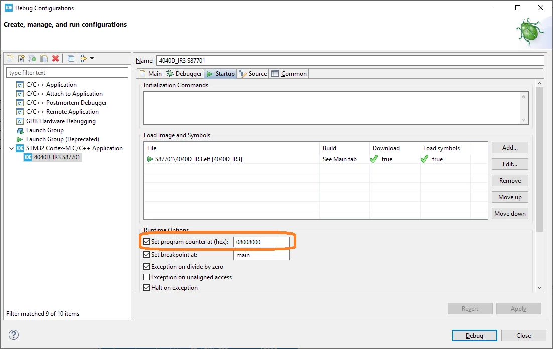

MFend
MFendAuthor
January 9, 2020

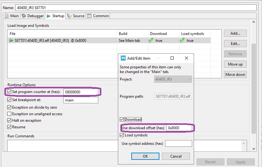

MFend
MFendAuthor
January 9, 2020
0690X00000BvmfZQAR.jpgUsing STLink:

MFendAuthor
January 13, 2020
How do I see entire conversation?
From the post at https://www.openstm32.org/forumthread2364 I understood another step, but it still didn't help the debugger to know where to start...

I upgraded to STM32CubeIDE 1.2.0 - still no change...debugger insists on starting at 0x8000efc!
