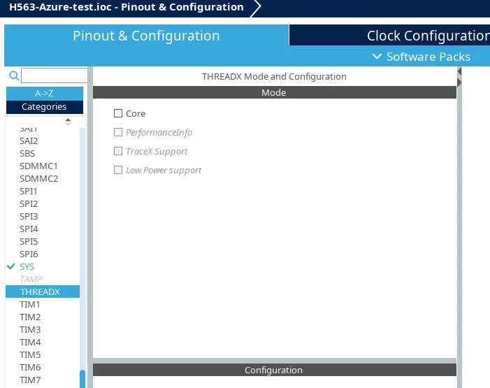

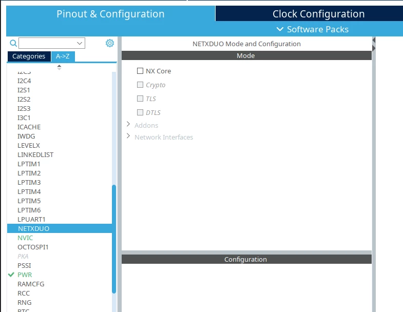

You should see it in Cube :
select core and then:
2 replies
AScha.3
AScha.3Best answer
Feb 21, 2025 12:09 PM UTC
