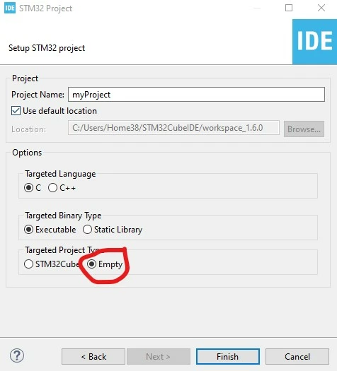

1) Let's create a brand new STM32CubeIDE so called "Empty": File > New > STM32Cube Project
0693W00000AMZf8QAH.jpgThen up to you to copy / paste your .c/.h files and add proper setups to get a build running (defines, includes, ...) based on project properties

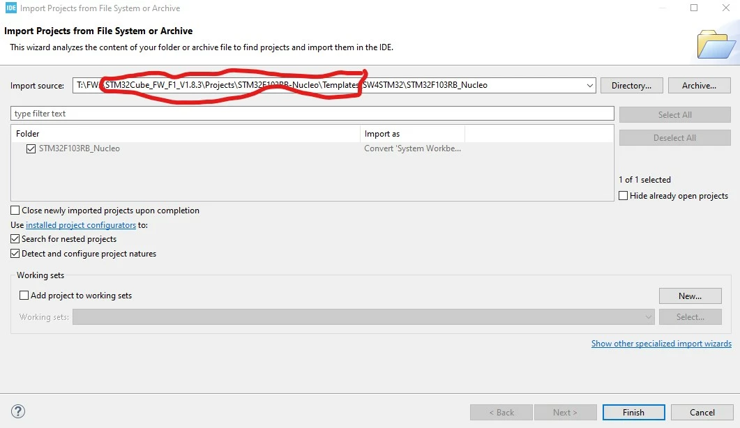

Or have a ty to import a "pre"-set project you can get from FW pack. File > Open Project From File System
0693W00000AMZgBQAX.jpgNote: Select your serie and board you need
Then still up to you to copy / paste your .c/.h files and add proper setups to get a build running (defines, includes, ...) based on project properties BUT already all drivers dependencies and setup should be available to you
