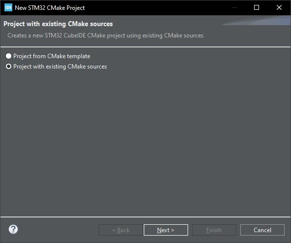

If you have already generated a CMake project and need to import it to STM32CubeIDE follow these steps:
  1. Open File>New>STM32 Cmake Project

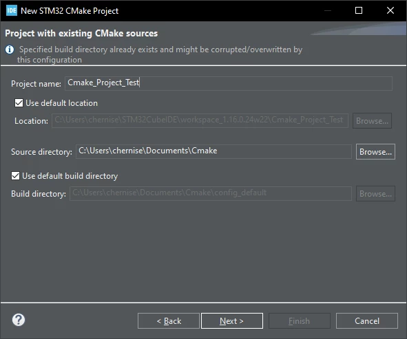

  2. In the displayed window select "Project with existing Cmake source"
  3. In the next window name the project and select the source folder to import

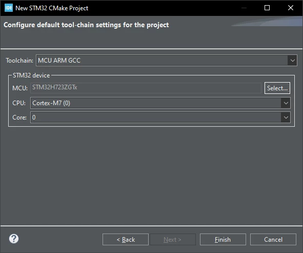

  4. Select the MCU
  5. Then you can continue the development, buid and debug
