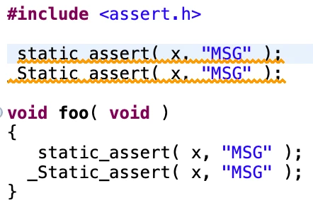

IDE recognition of _Static_assert
The STM32 compiler toolchain supplied with CubeIDE 1.13.1 recognizes the _Static_assert statement, but the IDE itself does not (it marks it as a syntax error).  Can this be fixed?  Is there a setting I can change in the IDE to stop flagging _Static_assert as a syntax error without turning off all syntax checking?
Image showing IDE highlighting _Static_assert statement as a syntax error:
Image showing correct compiler treatment of _Static_assert:
To be clear, this is not a show-stopping problem; it's just an annoyance factor.

    Where is _Static_assert  defined? The IDE needs to know about it and see the appropriate headers before the statement. Sometimes rebuilding the index can be required. Project -> C/C++ Index -> Rebuild. If you hit F3 on it, does it jump to the right definition?
    You can use static_assert instead, which the IDE will recognize.

    The behaviour is the same for static_assert() and _Static_assert(), but it only happens when they are used at file-scope.
    It looks as if the parser does not like function call syntax at file-scope - but they all compile as expected.
    I would like to use them at file scope to check things like alignment and sizes, but I am going to have to move them into a "random" function if I want to get rid of the error markers.

    In Project --> Properties --> C/C++ General --> Preprocessor Include Paths, Macros etc. add (as a USER ENTRY) an empty macro definition like
    _Static_assert(a,b)
    On the Entries tab, select CDT User Setting Entries
    then click Add...
    and pick Preprocessor Macro in the drop-down
    Feb 1, 2024 8:58 PM UTC
    That worked for me.  Thanks!
