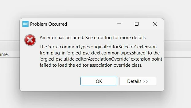

    Hello Neelesh,
    Importing mechanism is imperfect and has some flaws, quite a failproof option is to upload the project to some repository and then pull from it, this way everything is preserved, unless this project directory was inside some /user related folder with a specific name.
    Also .elf breaks whenever either folder was renamed or project inside Cube, without ticking option to "Update all references" this leaves former .elf file with an old name and breaks it.
    Regarding the import of the project I recommend deleting previously generated Debug and Release folders.
    Hopefully that helps!

    Dear Metyus,
    Thank you for the help, I tried what you suggested. I got an error which I attached long with this reply. Can you help me in this regard?

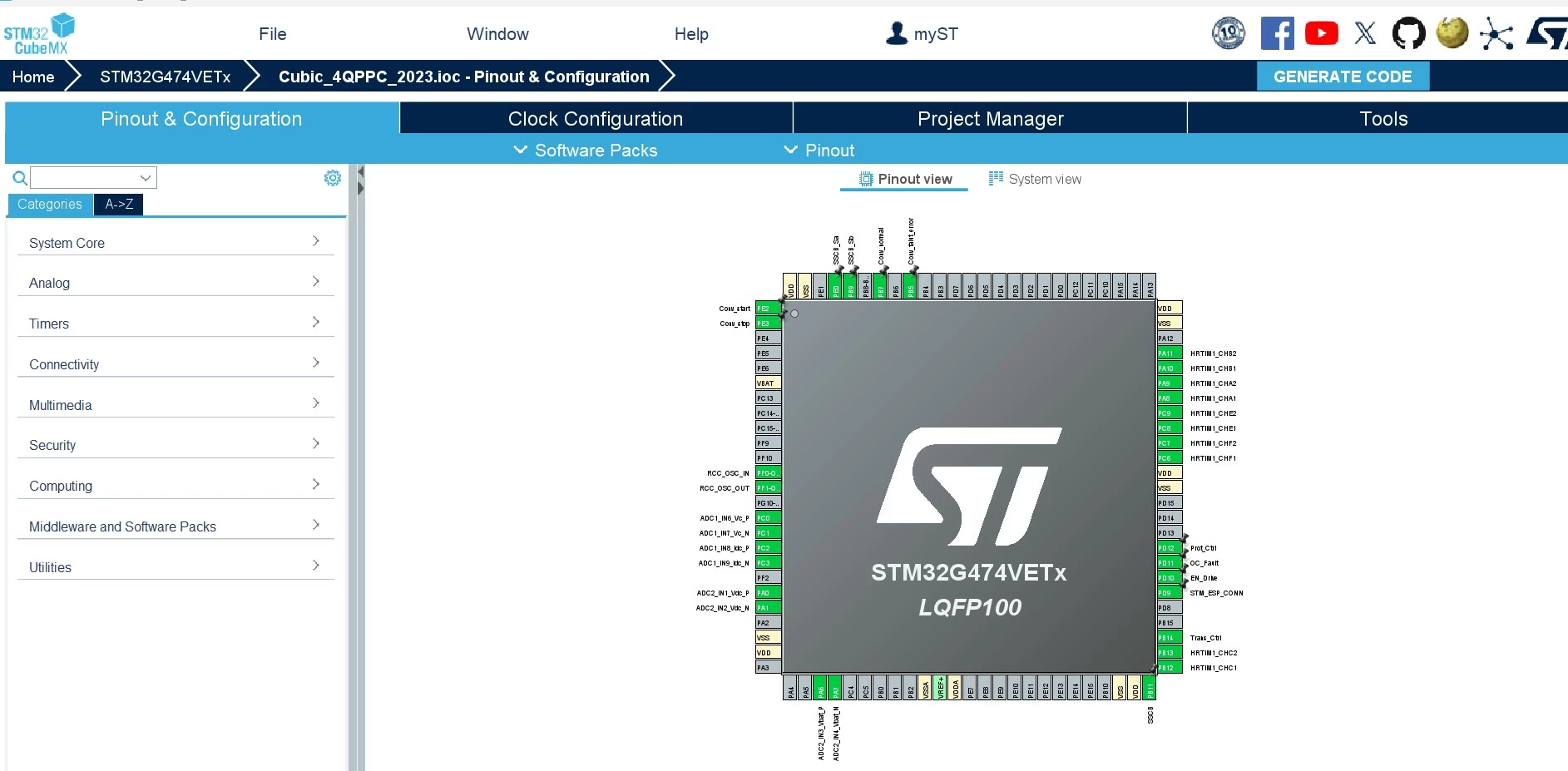

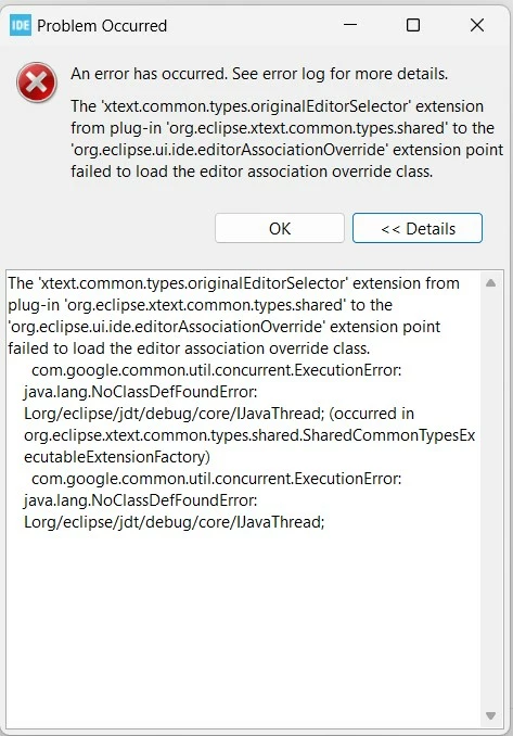

    August 29, 2024
    I m using the STM32 as shown in the attached figure. While importing this also comes. Is it necessary to share the project file? Let me know if is it so, I ll try to share the project file as well.
    Thanks

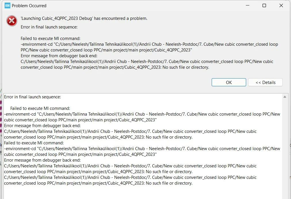

    August 30, 2024
    Thank you for helping.
     I tried as you suggested and this time binaries and .elf files were generated.
    But I have another issue now. can you give me any suggestions?
    Senior III
    August 30, 2024
    If it works,  please accept it as solution so that it will be useful to others.
    Regarding your issue,  are you able to program the devices? Make sure that you enable the debug pins in the cubeMx.
