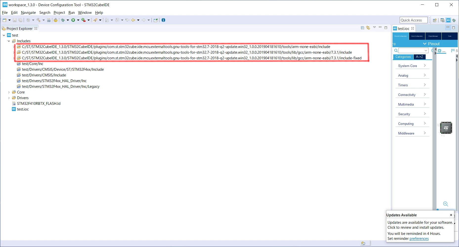

IDE include
Thank you for helping.
If you create a project with STM32CubeIDE, it will be included as shown in the image below.
Where is this set in the IDE?
KnarfB
KnarfBBest answer
Nov 23, 2020 7:26 AM UTC
project > properties > C/C++ general > Preprocessor Include Path ... > MCU ARM ... built-in compiler settings
