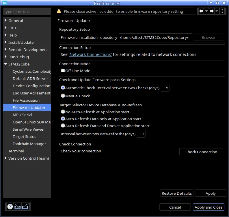

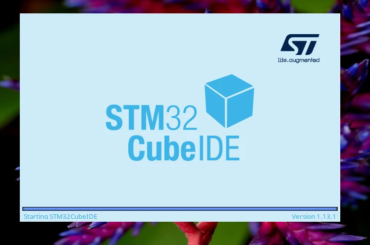

This is new "option" on splash screen:
!! on top: please close ioc editor --- on startup !!! Nothing is open !!
-> Apply and Close --> nothing happens , just (static) splash screen.
Is V1.13.1 .
Only killing the java process removes the splash screen, but doesn't help , next start of IDE hangs again:
Very annoying .

    Thx Oskar - i know. It happens now about 14 times the last 12 months .
    Just : delete > .metadata/.plugins/org.eclipse.e4.workbench/workbench.xmi < , then it might (!) start again.
    And i have some backups (copies) of this workbench.xmi , copy/rename to workbench.xmi and its starting again. But this is NO solution , this is just some last chance to avoid to delete the sick freak .
    I cannot imagine, its so big problem to find out , whats going wrong (for the great software freaks at STM ) , if they had any interest to do it.
