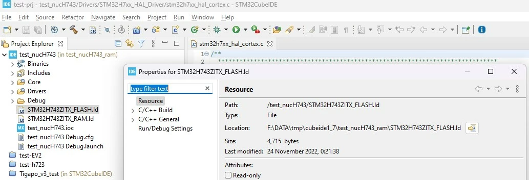

After importing an Eclipse project for 32F407, I notice that CubeIDE shows files from a different path to the path for that folder shown in it's properties (right clicking on the folder icon). It opens files from the different path, lets me edit those, but when it compiles, it uses those from the path shown in properties!!!
How can I fix this?

To solve well your issue we need to inform us some details :
  1. From where do you import your project ?
  2. Could you provide a screenshot on which we can see the path of your project ?

  1. I already said that I imported it from an Eclipse IDE project.
  2. The path is listed in properties, it shows d:/projects/zte/st/src/drivers but actually uses d:/projects/smewrt/st/src/drvers. It's like a mirror file structure exists.

Pavel A.
January 6, 2023
The file location in Eclipse can look "unexpected".
To see the real location, open the file properties and click on the resource tab.

Again, note that a file in eclipse has a path in the "eclipse filesystem" and it differs from the real path in the OS filesystem

The question is how to change the path variable PROJECT_LOC, which is shown in the Properties/Resources->Linked resources dialog, but the edit button is greyed-out.
For some unknown reason the IDE is compiling from this directory if the file exists there, but if not it fetches from the correct source which is in another directory off the project root.
Double clicking on a file shown in the Project Explorer window opens files from the correct source directory, but it only compiles files from the PROJECT_LOC files.
PROJECT_LOC cannot be changed, it is a constant set by Eclipse. It points to the location of .project and .cproject files.
The root project folder is on the sources path... but then the builder would compile two .c files with same name, this would cause a linker error later. The other .c file is included in the project, so it must be compiled. Strange.

You don't understand Pavel.
The IDE shows the files in the project, they are the files in PROJECT_LOC\eclipse\src.
I can click on them to open and edit.
But those files are NOT the ones it compiles.
Instead it is compiling the files in PROJECT_LOC\STMWST\src.
But it does not show the path PROJECT_LOC\STMWST
Do you understand the problem now?
