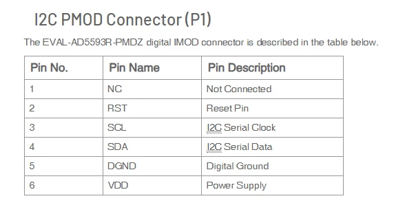

Hardware Connections:
STM32 Pin 2 +3.3V -> AD5593R Pin 6 Vcc
STM32 Pin 6 GND -> AD5593R Pin 5 GND
STM32 Pin 34 I2C2_SDA -> AD5593R Pin 4 SDA
STM32 Pin 36 I2C2_SCL -> AD5593R Pin 3 SCL

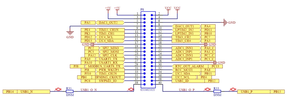

The STM32H757XIH6 uses a TFBGA package. The TFBFA pins are labeled Row A-S and Column 1-17. So how are you coming up with Pin 34 and Pin 36?

April 22, 2024
Due to the fact that the microcontroller is embedded in the display, the user only has access to a 40-pin header, covering a variety of peripherals. I have attached a copy of the pinout for the header called STM32H7 Pinout above, where the pin numbers come from. The proper pin names are PB11 (I2C2 SDA) and PH4 (I2C2 SCL). Thanks for taking a look.
