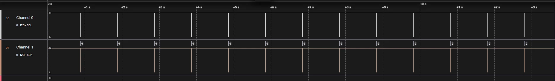

What I want to implement is I2C communication.
There is one master(NUCLEO-U575ZI-Q) and slave(LK432KC).
Master transmit TX_Buffer_1 which is double 3.0
and Slave recieve it in RX_Buffer_1.
Slave doubled RX_Buffer_1 and transmit to master.
I use memcpy and Slave_RxCallback function to implement it.
I attached 2 main file each is master and slave.
And I also have logic analyzer to detect SCL and SDA line.

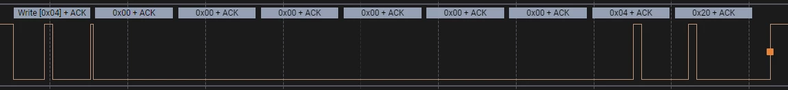

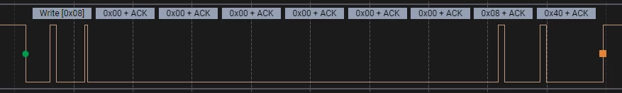

In my code, Master transmit only 1 slave address (0x08) like this picture,
but sometime it appear like this..

    Use external pullups. The internal pullups are 40kOhm nominally and usually not adequate.

    I change pullups resistor into 4.7kohm.
    It still have various problem ;( but your solution helped a lot, thank you :)
