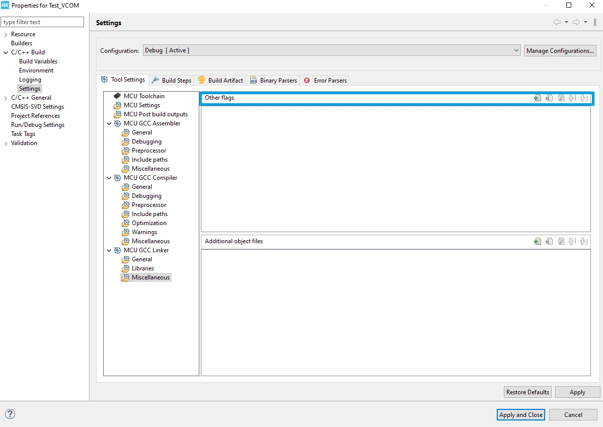

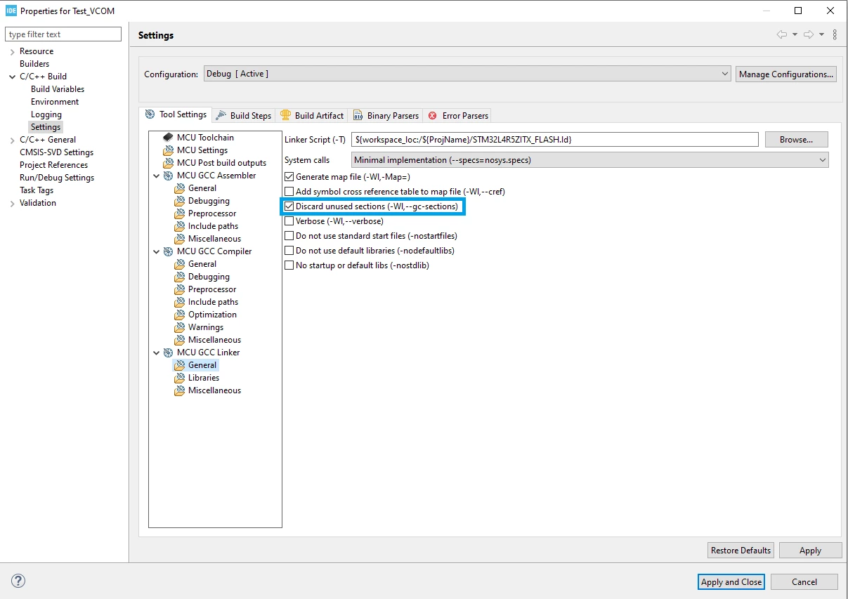

I want to discard unused sections using -gc-sections and -ldo, but I can't find where to do that in the environment. The version of STM32cubeIDE I'm working with is 1.12.1, Any help would be greatly appreciated.

The option you are asking for is already activated by default in CubeIDE. Under "Properties / C/C++ Build / MCU GCC Linker / General" you will find a check box associated to the "-l--enable-non-contiguous-regions" option.
I just want to add that in case you need to add any GCC Linker command, which is not already embedded in the tool, go under "Properties / C/C++ Build / MCU GCC Linker / Miscellaneous" and add the command in the "Other flags" section.
