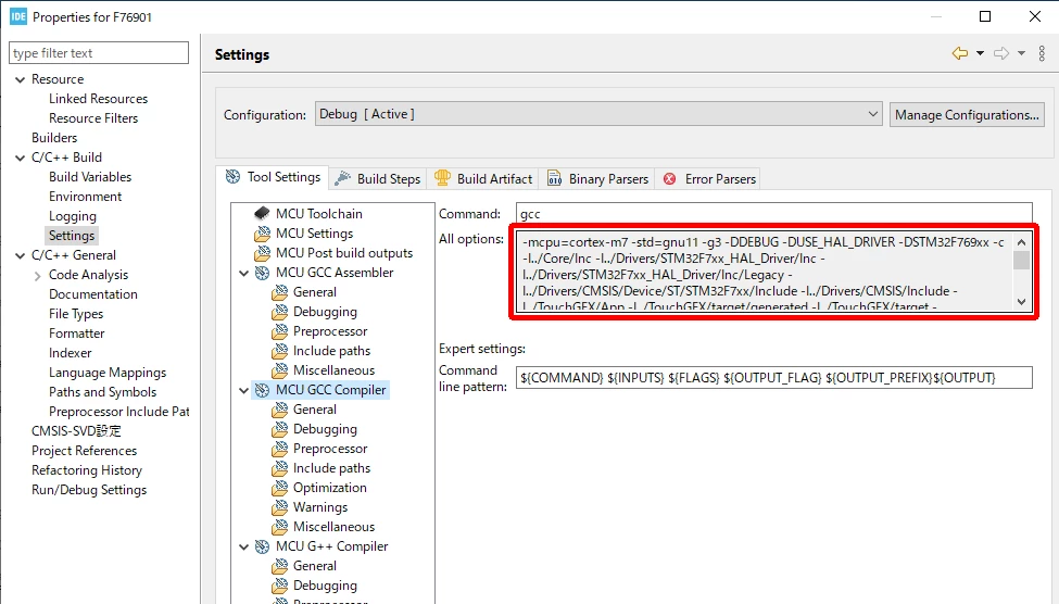

How do I add image compilation options?

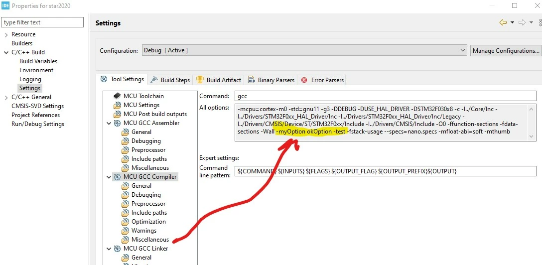

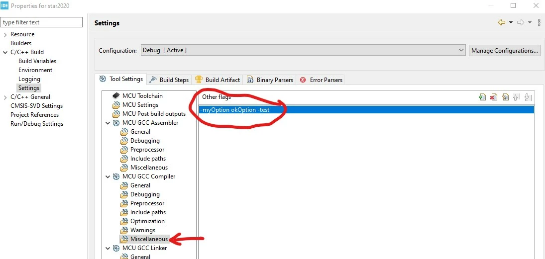

Custom settings can be set like this:

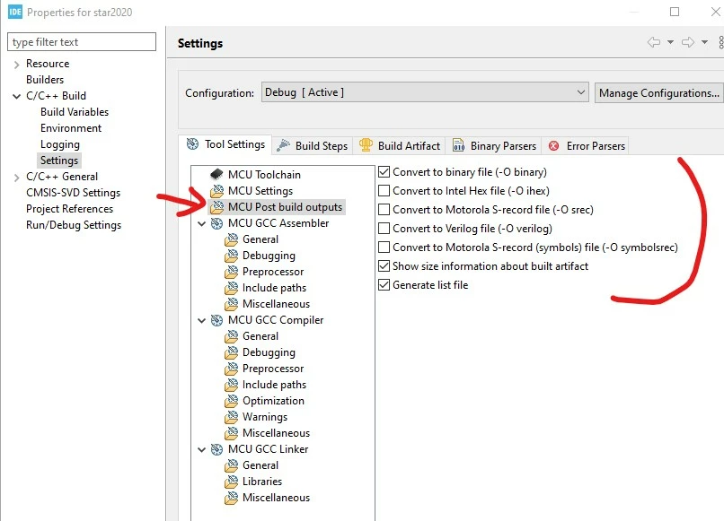

If discussing about binary artifacts some presets are available:

Thank you for your response.
I'm sorry to have you prepare the image.
I understood it well.
I'll give it a try.

Where are the pre-existing compile options set?
Can't it be edited?
