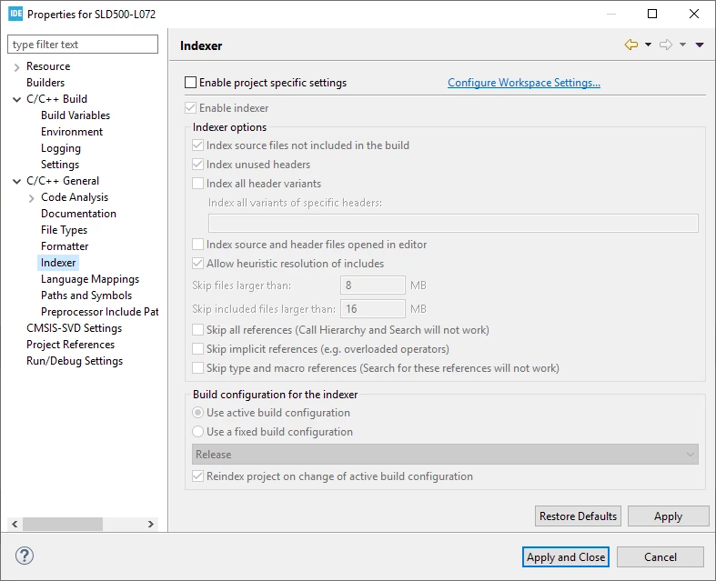

I redo some tests this morning and as I see the issue seems to be located in the editor it self, for instance a 'DEBUG' symbol that is not defined in release is still considered. Compiled code seems to be ok. Have look in the attached in the screen capture.
Pavel A.
April 18, 2020
Aha. This actually looks like indexer issue: it does not follow the active configuration, so the #ifdef'ed section remains shadowed.
Try to re-index and check the indexer settings in Eclipse.

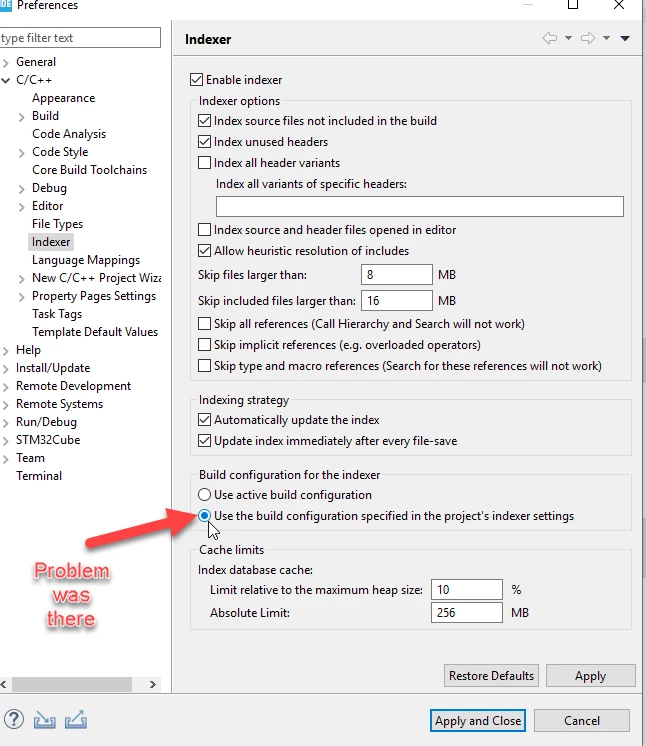

:grinning_face: 0693W000000W3NMQA0.png
changing to 'Use active build configuration' fix my problem.
When I look in the project indexer I cannot find explanation of the previous behaviour or maybe I'm not looking at the right place ;)
I have the impress that the project settings was referring to general settings and general settings was referring to the project settings...
