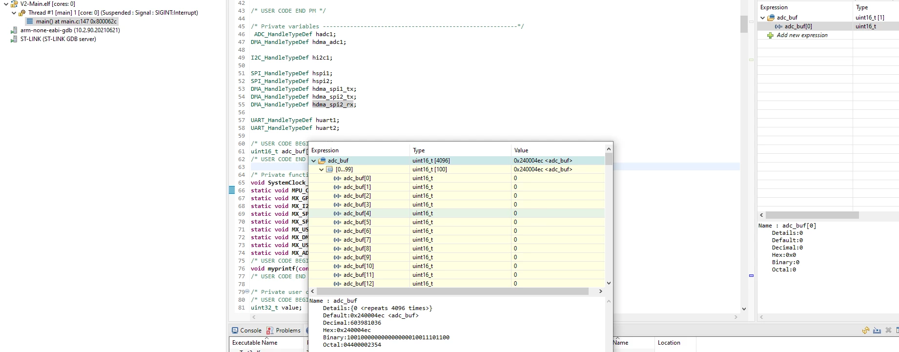

DerekS
DerekSAuthor
March 17, 2022
Thanks for your reply! I dived a bit more into how to properly store DMA values and ended up using this source, https://www.digikey.com/en/maker/projects/getting-started-with-stm32-working-with-adc-and-dma/f5009db3a3ed4370acaf545a3370c30c
I used their method and came up to this conclusion
0693W00000Kd2qcQAB.pngThe error flag for ADC is still at 1 and the ad_buf just sits there with 0s forever never triggering a half filled callback. Any other suggestions would be greatly appreciated.
Here is the new relevant bit of code.
