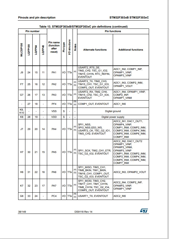

0693W00000DnU3tQAF.jpglol Sorry for the typo. You are correct I did mean Accelerometers. As far as the user manual, (again I'm new) the attached screenshot Is what I see. Where multiple ADC1, ADC2, Ect associated with multiple pins. Is this the table you are referring? For the Sample rate, my end state would be to use multiple accelerometers, 2 to 4, to record the vibrations in a metal, probably a steel, and determine the location of the vibration. (example: if i had a pipe i could put the accelerometers at either end and determine the location of the noise based on known distance, the time the signal is recorded at each location and the known speed of sound of the material). I dont know the exact Hz but probably close to 1KHz, as far as the sample rate, I want to get close to 4MSPS. The high sample rate because sound moves fast in metal. I like TDK's Comment where I should start with one channel at a slow sample rate and then take small steps from there.

The table is the correct one, and is actually in the device data sheet. The F3 User manual is a different document and provides programming related information. Programming examples should be included with the HAL Peripheral Library for the F3.
You have a very challenging task. Accelerometers have a sense frequency much less than your sample rate. Your material will have two different vibrations - low amplitude high frequency vibrations that translate axially down the material, and lower frequency higher amplitude lateral vibrations (think of a whip). When you say speed of sound in a metal you probably are thinking of the axial vibrations, but the accelerometer response will likely detect only the lateral vibrations. My caveat is that I could be wrong, and look forward to your success report.
