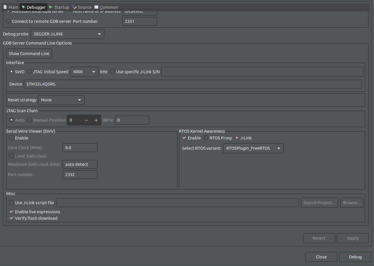

I just upgraded my IDE to 1.9.0. I am trying to get Segger JLink to work in debug mode. It is able to connect and download the firmware to the MCU but it shuts down straightaway after doing so. How do I stop it from shutting down? It didn't do that 1

I'm not a J-Link expert so if nobody is able to help you here then perhaps you would need to use the Segger forums. However, it looks like you might be using "Run" and not "Debug"? Possibly the -s command that activates the 'singlerun' option?

Thanks so much for getting back. I deliberately changed the mode in my project settings to Debug mode and the result remained the same.
Could you advise where I might be able to remove the -s switch? I attach a screenshot of my J-Link settings.0693W00000LxRB8QAN.png

Another question. Which OS are you running on when encountering this issue?

This is Ubuntu 20.04.4 LTS. I tried using in Windows 11 and it worked without problems.

Confirmed up-stream regression in GDB.
This issue only exist on Linux (from what we know today)...
Not possibility to fix this for the next release. Since, there is no plan to update the toolchain in the next release.
Possible work-arounds:
  • Use the toolchain from CubeIDE 1.8.0 based on GCC version 9.
  • Or replace the arm-none-eabi-gdb.exe only from GCC version 9 and use it with GCC version 10.
Internal ticket reference 126202.
