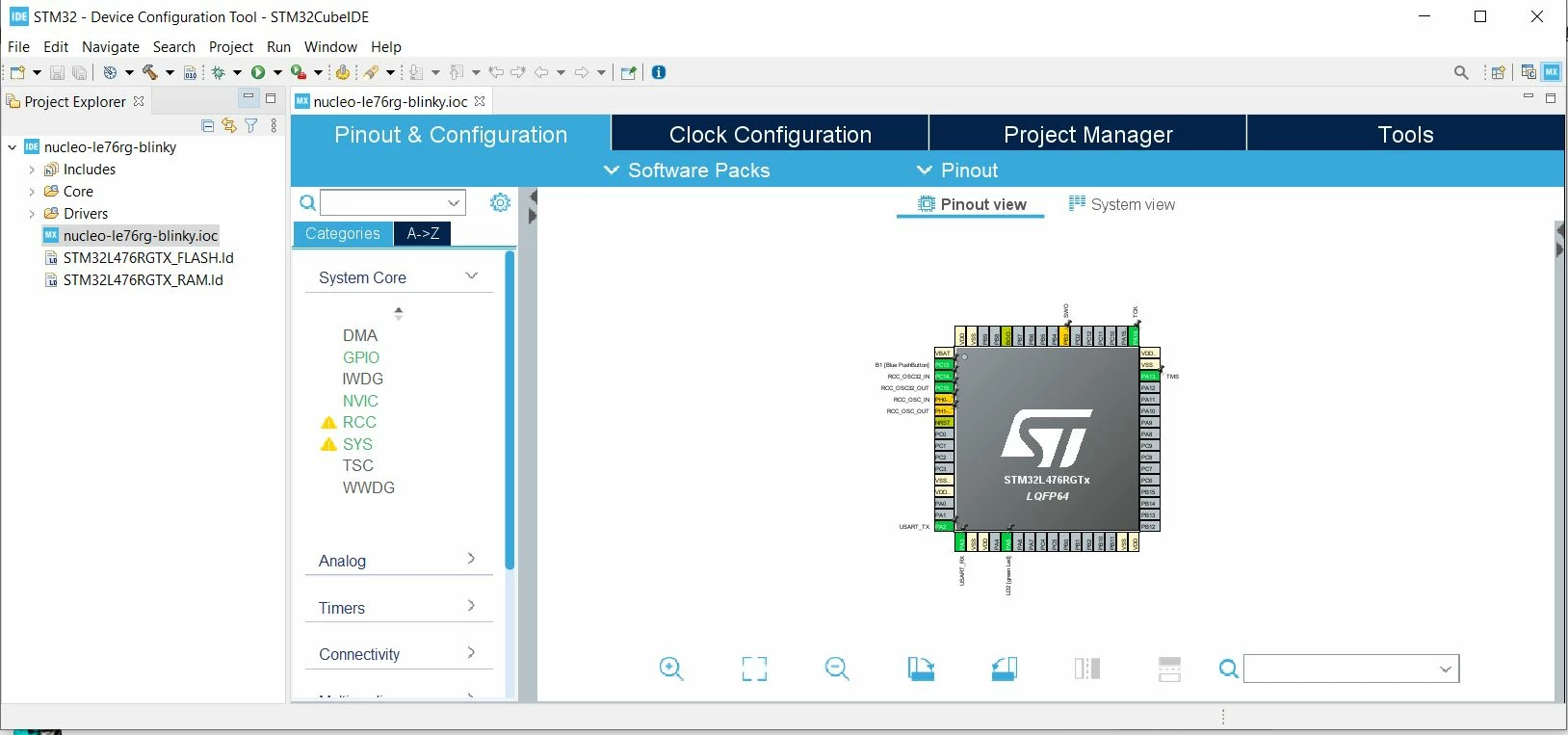

I installedCubeIDE and have the NUCLEO L476RG board connected. It contains the default program and is responding to User button. I do not see src folder on left and do not know how to save and get started. Please help

Simply setup and manage all GPIO and peripherals in ioc window and close ioc. On closing code is generated for you and in Core left can select... open files...

There are source files within the Core folder.

Thanks @TDK​. I am able to locate the source files
