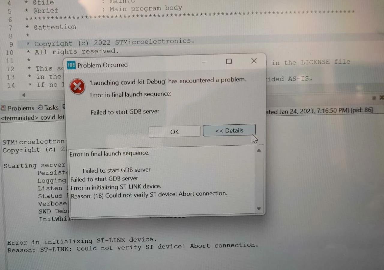

I have tested my code in blue pill and now have made my custom pcb containing stm32f103c8t6. I am unable to program with my st link. The ettings on stm32cubeide are correct as the code gets uploaded in the bluepill. Do we have to set or reset the BOO

I have tried both ie. using another original ST-link V2 and by resetting the BOOT0 pin. Still the code is not uploading...
Just to clarify- I am programming my stm32f103c8t6 based custom made pcb with ST-Link V2 via I2C (Vcc, Gnd, SWCLK, SWDIO).
in this case, Are these 4 pins enough to program the uc or is setting/ resetting of BOOT0/ BOOT1 pins required ?

What messages do you get while attempting to program the MCU? And what's your "original" ST-Link. If it has a pendrive-like metal case, then it's not original.

Below attached is the error message i get.
And yes u r right, ST-link v2 i am using is not the original one then.0693W00000Y921ZQAR.jpg

So, you have an illegal ST-Link clone which ST does't want you to use (it still partially allows it, but slowly the policy is being tightened) and, very likely, you are trying to debug a STM32F103 clone, which violates the STM32CubeIDE license.
ST Microelectonics software still (maybe not for long) PARTIALLY works with ST-Link clones and ST MCU clones but this support is shrinking with every new release of software.
