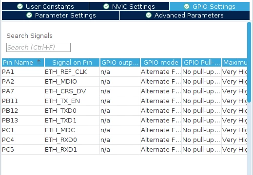

I have STM32F407 and RJ45 connector. Can anybody tell me which stm32 pin to connect which RJ45 pin, so that i can go ahead with the web server over Ethernet project,RJ45 connector has 8 pins

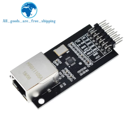

right. need interface chip. i would take a cheap module, like this:
https://de.aliexpress.com/item/1005004446133417.html
0693W00000aH4K3QAK.pngalready with rj45 ...
to connect : gnd, vdd , and these 9 pins:

which board ? selfmade STM32F407 ?
STM32F407 chip has RMII interface, not rj45.

so with RMII, how would I access the server over my router which has 8 pin RJ45 sockets
Am I supposed to use third party interface chip
