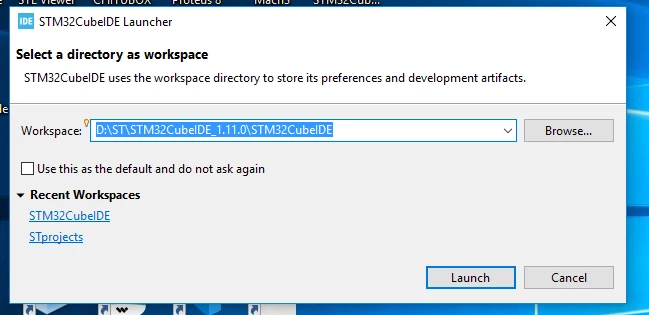

I have installed STM32CubeIde, however beyond the flash screen the software is not loading

SatishB
SatishBAuthor
January 16, 2023
I am using version STM32CubeIDE 1.11.0. I have attached the screen for your reference.
Thanks Oliver for your reply.

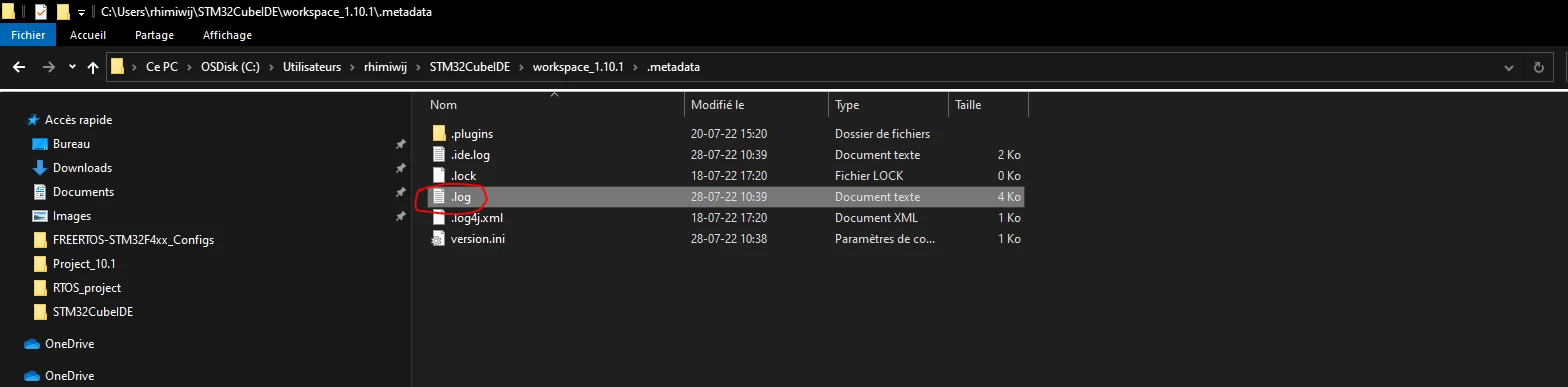

Wijeden RHIMI
January 17, 2023
Hi SatishB,
Could you please provide the .log file of your workspace.
Thanks,
Wijeden,

Wijeden RHIMI
January 18, 2023
Hello @SatishB,
I wonder you to check the following stuffs :
  1. My gut feeling is that installation is broken or that your environment prevents it from executing properly (installation failure or firewall / anti-virus)…
  2. Is that the full .log file or just pasting a part of it ? (it seems that the copy paste .log file is useless :pensive_face: ) --> if it is the case please share the whole file .
  3. Maybe you should use the command line to launch the Cube IDE
I wait your response :).

SatishB
SatishBAuthor
January 18, 2023
Hi Wijeden,
  1. I have given you the full log file.
  2. I have disabled antivirus while installation
  3. What is the command line command to launch

SatishB
SatishBAuthor
June 27, 2023
I am working on Windows 10.
As a workaround I am able to start the application using this file "stm32cubeidec"
