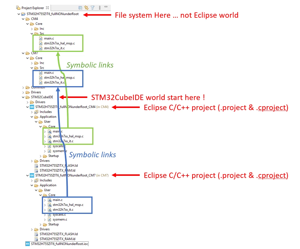

I have installed STM32 IDE on windows 10 , I wanna build a very simple code, LED blink but I can not build the project and run it ... can you please help me ?

1) My guess is you're facing this kind of project view:

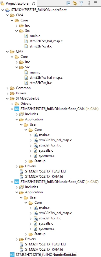

0693W000005AVJnQAO.png2) Assuming my guess is right here is same snapshot but adding some annotations to:
0693W000005AVKRQA4.pngHere we are able to see main.c duplication you're refering to. Duplication is from UI point of view but looking at file system you may get only one main.c per cpu what's sounds reasonable. Dupes are related to symoblic links usage ... takes care to small back arrows which are overlaid on some file with your project tree ...
Based on such behavior you're reporting about some directories allowing compile process trigger, some others not is fully explained and common / expected behavior:
+ Directories not allowing to trigger compile process are in fact pure file system folders not being managed / understood by Eclipse at all (because no Eclipse metadata inside)
 + Directories allowing to trigger compile process are in fact not only pure file system folders but Eclipse projects (some Eclipse metadata inside like .project & .cproject files)

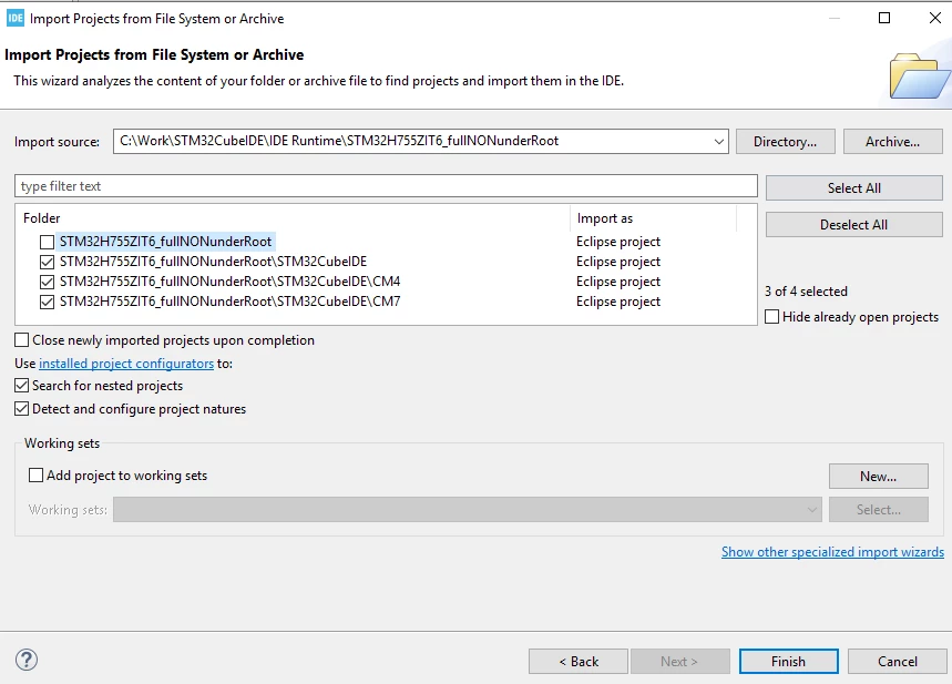

3) Then you may say all such is quiet weird but hopefully some way to get better look'n feel. You've to take care importing your project.
0693W000005AVZqQAO.pngTaking care to not import first element (i.e. file system project root) you're already getting a more user friendly view preventing dupes:

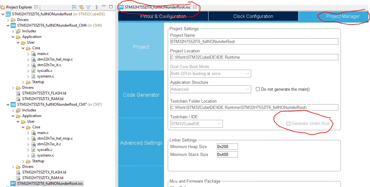

4) My latest guess is you're facing all such either because relying on one of following workflow
+ Having imported project from a STM32CubeMX stand alone tool project creation process unchecking "Generate Under Root" option.
+ Having imported an STM32Cube example project from a firmware pack
+ Having taken as reference doing q copy or ... for your own dev. one of 2 previous proposals
To confirm let's open your .ioc file you may see:
STM32Cube examples are all generated having such "Generate Under Root" option unchecked.

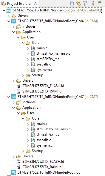

5) As conlusion:
According to me I would adivice you to always rely on Generate Under Root" option checked. It will make your life easier I think.
Such is by the way STM32CubeIDE default setting creating a project from its context.

@STork.1​  any console log to share ? If build is not initiated either some messages as part of console or even not able to trigger a build (selecting your project from Project Explorer Tree view is toolbar hammer icon enable ?) ?

thank you for your reply and sorry if I reply late. the problem is solved. I work with STM32H755ZIT6, a dual core MCU. main.c can be open from 2 directory. when I open it from the root directory of the project, it can not be built but, when I open main.c from the CM7 directory, it can be built. another reason was that when numerous projects are open at the same time, the corresponding main.c file of the project can not be build... it seems that is a bug of the IDE.

Sorry for my late reply, Thank you very much for such a complete and detailed explanations. what you assumed is exactly what I faced and as you explained in the second and third part of your explanations, my problem is now solved .
