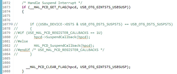

Hello all,
I encountered exactly the same issue.
My setup: custom board with STM32F105RB, USB used as CDC device only meant to exchange messages with host PC.
IDE: STM32cubeIDE 1.5.1, STMcubeMX 6.1.1.
Configuration in STMcubeMX:
USB DEVICE: Class CDC, all other settings with defaults.
USB_OTG_FS: Mode Device Only, all other settings with defaults.
After many hours spent debugging i found strange behavior in below IF block inside stm32f1xx_hal_pcd.c file.
If i put a breakpoint before the IF, when the USB cable is disconected, the breakpoint is hit. When the execution is continued after the breakpoint the IF is skipped because the condition inside IF is false.
But if that breakpoint is removed and another one is placed in the line with HAL_PCD_SuspendCallback(hpcd), that breakpoint gets hit although with the previous breakpoint it was never executed because the IF condition was not met. It seems something is polluting the variables used in IF statement, which doesn't happen in case of breakpoint above the IF statement.
In case HAL_PCD_SuspendCallback(hpcd) is not executed the USB cable disconnect is handled ok, and upon USB cable reconnection the USB device is recognized by PC. It seems that call to HAL_PCD_SuspendCallback(hpcd) is causing this issue.
So my solution was to just comment out that part of the code containing the IF statement and HAL_PCD_SuspendCallback(hpcd) .
After that, connecting and disconnecting work as expected, as well as the data transfer between my STM32 board and the PC.
Hopefully somebody will come up with a proper explanation of such behavior.
In stm32f1xx_hal_pcd.c i have commented the following bold part of the code:
  /* Handle Suspend Interrupt */
  if (__HAL_PCD_GET_FLAG(hpcd, USB_OTG_GINTSTS_USBSUSP))
//   if ((USBx_DEVICE->DSTS & USB_OTG_DSTS_SUSPSTS) == USB_OTG_DSTS_SUSPSTS)
//#if (USE_HAL_PCD_REGISTER_CALLBACKS == 1U)
//    hpcd->SuspendCallback(hpcd);
//#else
//    HAL_PCD_SuspendCallback(hpcd);
//#endif /* USE_HAL_PCD_REGISTER_CALLBACKS */
   __HAL_PCD_CLEAR_FLAG(hpcd, USB_OTG_GINTSTS_USBSUSP);
