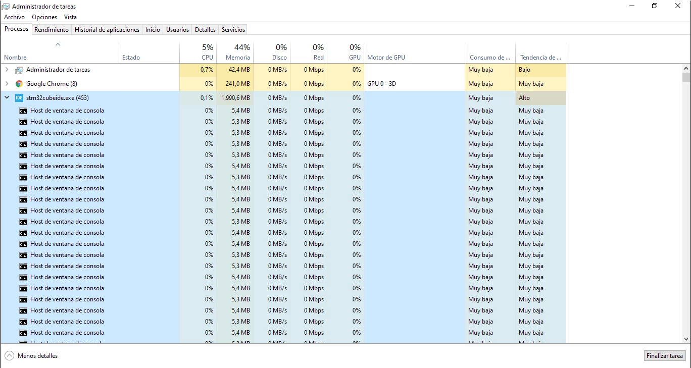

I have a problem with the STM32CubeIDE, it consumtion a lot of memory ram. In the task manager it open many conhost.exe process (i attach an imagen). Can you know how avoid open many conhost?. (sorry for my english)
  • December 16, 2019
  • 7 replies
  • 4371 views
I've seen that when I compile the code all the conhost.exe processes are delete but after that, the conhost begin to open automatically like in the attach imagen.

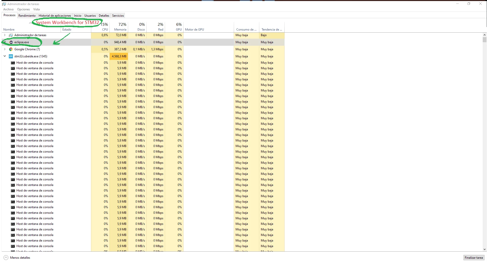

Yes, I know, but the System Workbench for STM32 is eclipse too and it doesn't have the problem of memory consumption (I attach an imagen), in the imagen the stm32cubeide is using more than 4.5 GB while System Workbench for STM32 just 948 MB. Maybe I have some wrong configuration in the stm32cubeide or some virus but windows defender has not detected anything. I tried uninstall and reinstall the stm32cubeide but the problem persists.
