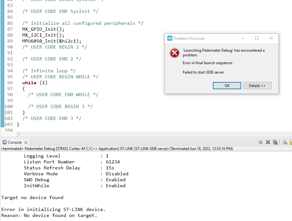

I have a problem with GDB debugger on stm32F401re, i can't connect to target because it is not found. How can i resolve?

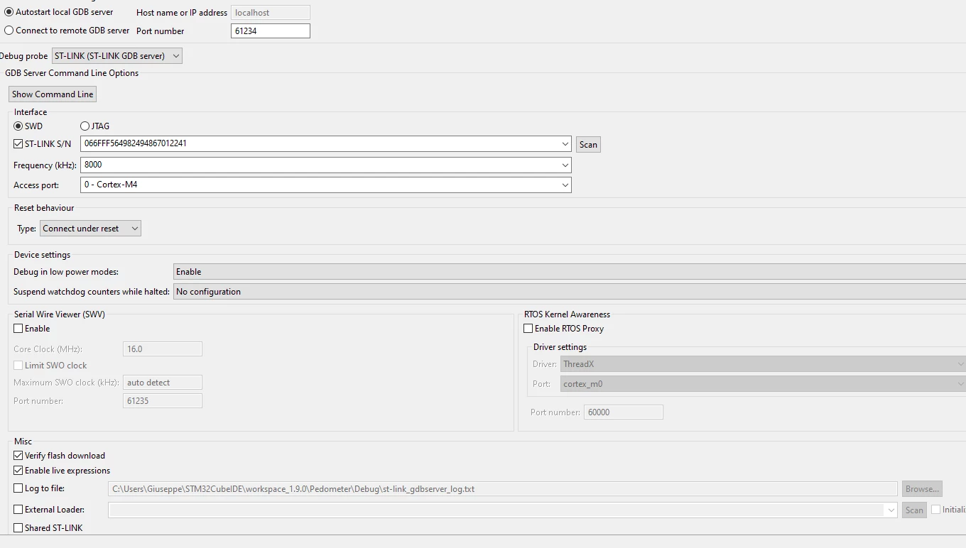

Maybe your MCU is in low power mode or code used SWD pins. Enable under reset and low power debug.
GGeno.1
GGeno.1Author
June 19, 2022
Thank you for the answer... I have this configuration... there are already under reset and low power debug.

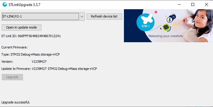

Maybe you have STLink Clone without reset line or your stlink need upgrade firmware.
GGeno.1
GGeno.1Author
June 19, 2022
I have already done upgrade firmware, the problem is happened after a session of debug on the firmware with SYS debug disable in the configuration...could be this the cause?
