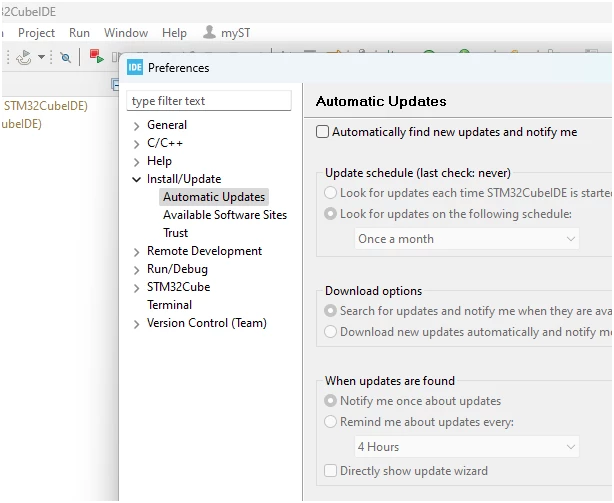

I have a crash with CubeIDE 1.16.0 on win11, but no logs in the install dir
How to resolve crash issue?
Tried both stm32cubeide.exe and stm32cubeidec.exe

Aug 30, 2024 10:05 PM UTC
Sorry? CubeIDE should not need to *run* as administrator.
@retif Try this: rename or delete your workspace directory (c:\users\oleks\stm32cubeide\winding).
Then disconnect from network so that it won't attempt to update at start.
Create a new workspace. Disable any automatic updates on start (in Preferences). Then exit and run again. Will it open?
