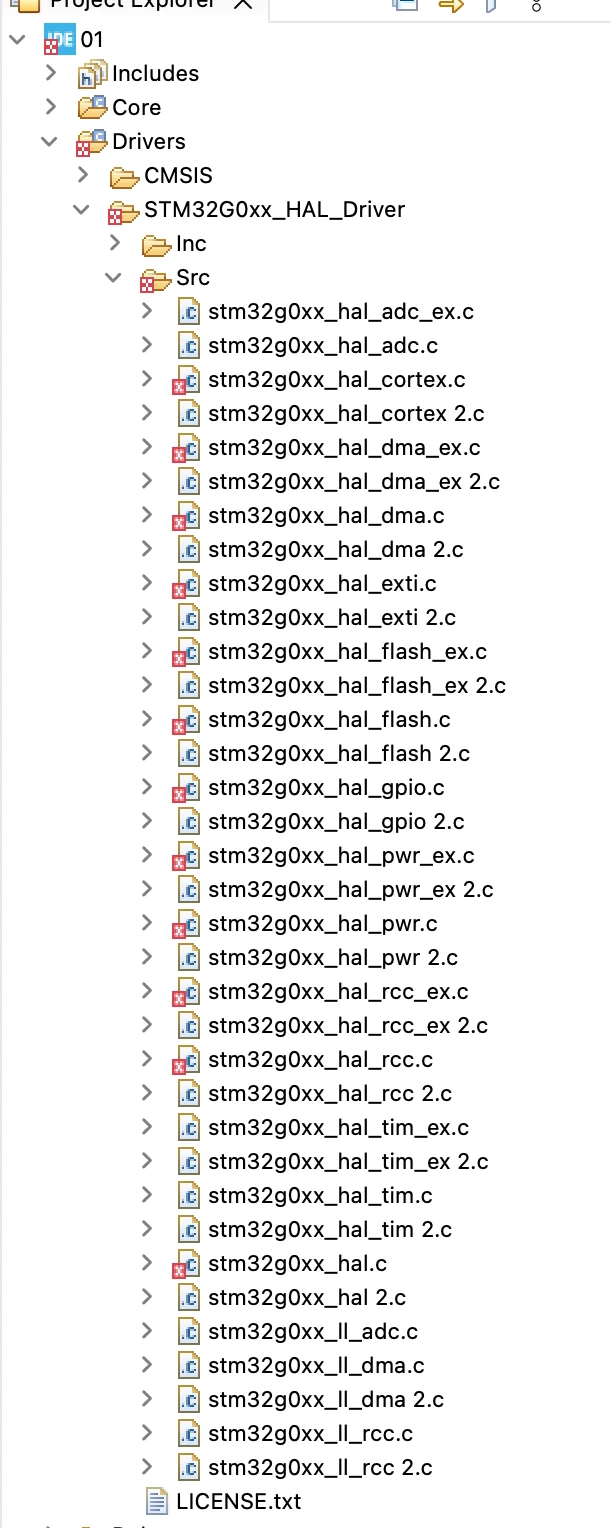

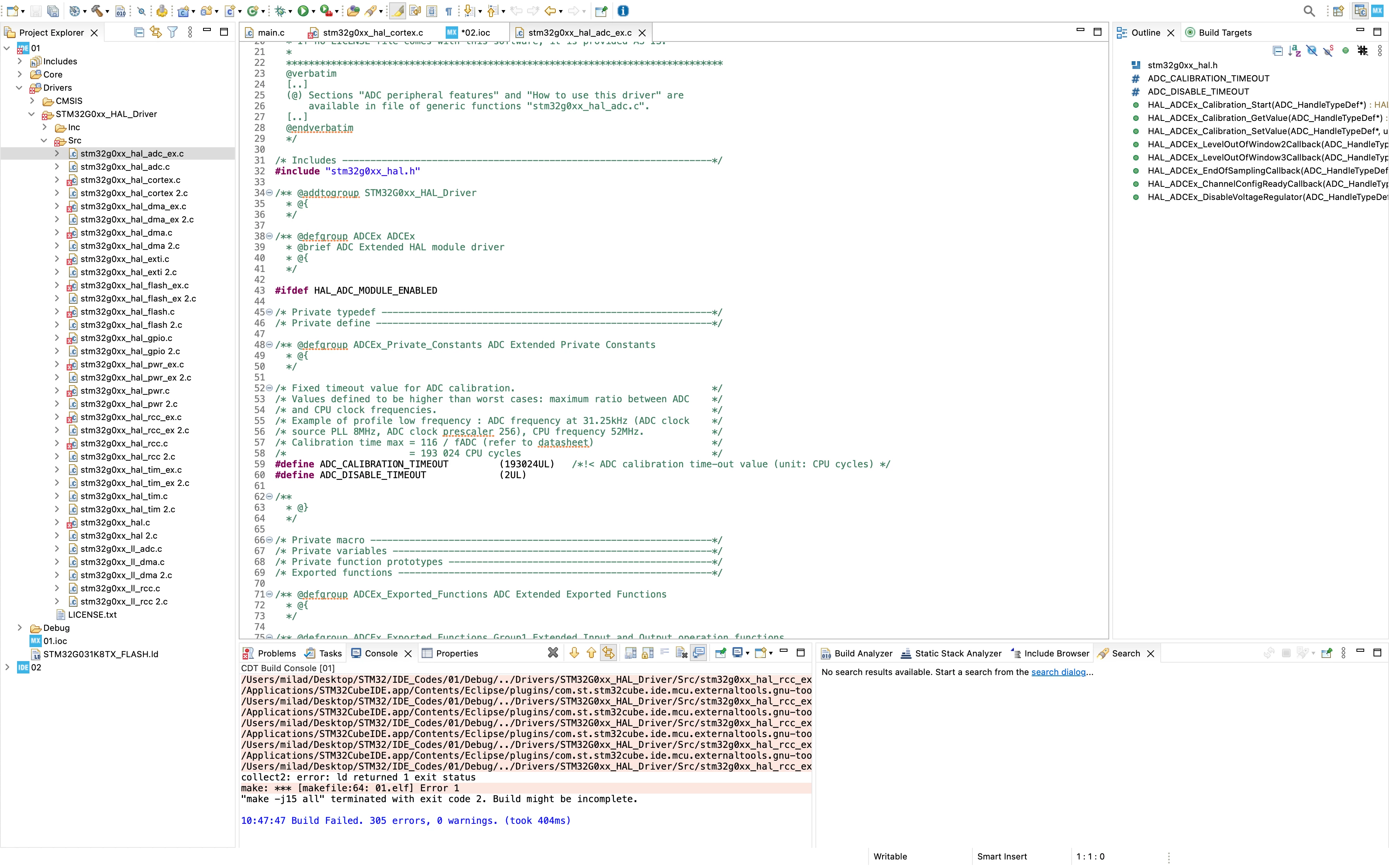

I got an error in my drivers(src) part. it is visible in the picture which I attached
I just started CubeIDE and I use macOS. I think there is a missing in installation as error is in driver part (Src)

Which type is this error ? Can you show the complete error ?

I ran the code in the windows it works properly but on my macOS system there is a red error on Drivers part. Please find the picture of that part in attachment.

All the files in red are a double. You can see "stm32g0xx_hal_cortex.c" and "stm32g0xx_hal_cortex 2.c". I think you can remove all files number 2.

yes it is working now. thank you :folded_hands:
