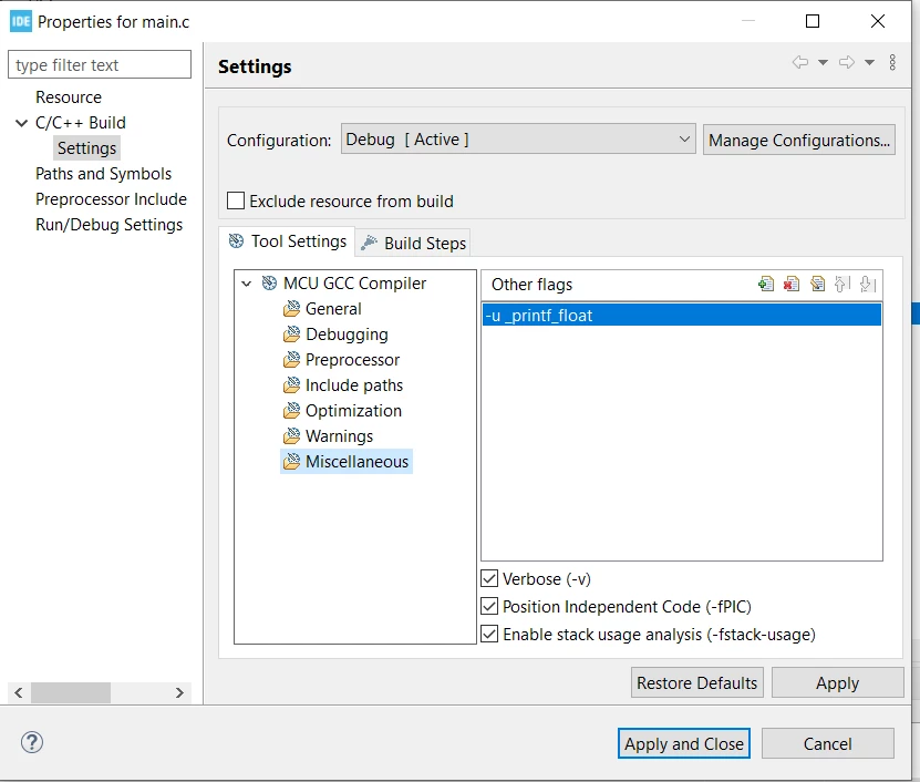

I get an error saying "The float formatting support is not enabled, check your MCU Settings from..." and i add "-u _printf_float" in linker flags but i still get this error.
0693W00000JNM7pQAH.png I updated my IDE and i am using the latest version (1.6.1) now. I cannot solve it.
4 replies
KnarfB
January 26, 2022
latest version is 1.8. But it shouldn't matter. What you are showing is a compiler flag, not a linker flag. Select the whole project first, then there should be a linker section in the Tool settings tree.
hth

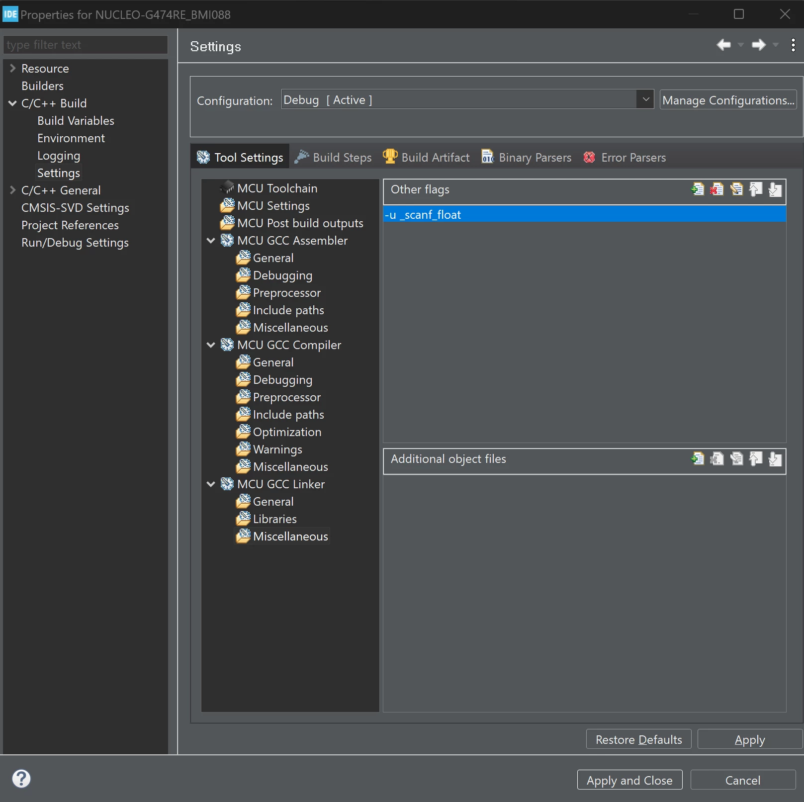

January 17, 2024
For Version 1.14.0 you can solve it like this:
-Click on you Project (The Blue Icon with the Project name behind it)
- File --> Propoerties --> C/C++ Build --> Settings --> Tool Settings --> MCU GCC Linker -->
Other flags --> add --> Insert "-u _scanf_float" without the "...".
- Rebuild your project
