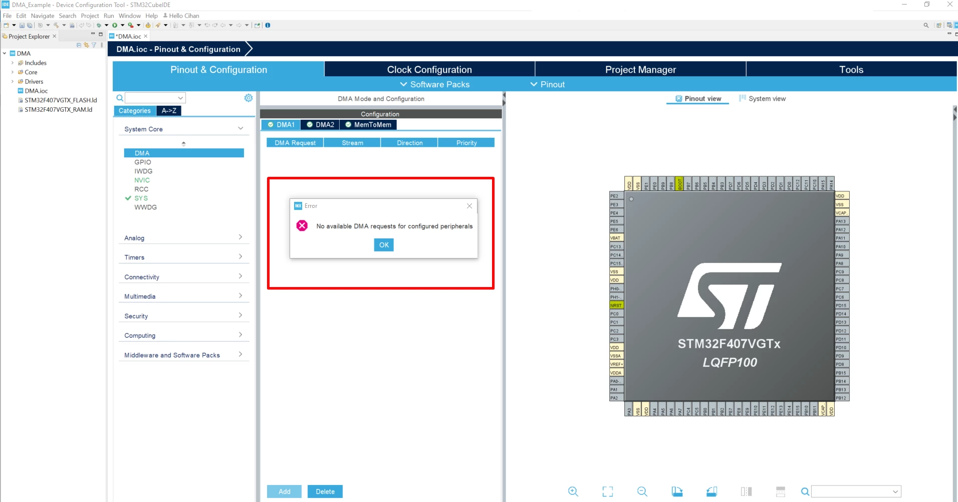

I cant set up DMA
I am trying to replicate this example by ST to understand DMA but I come up with below issue when I click on Add. Could you please help me resolve it ?

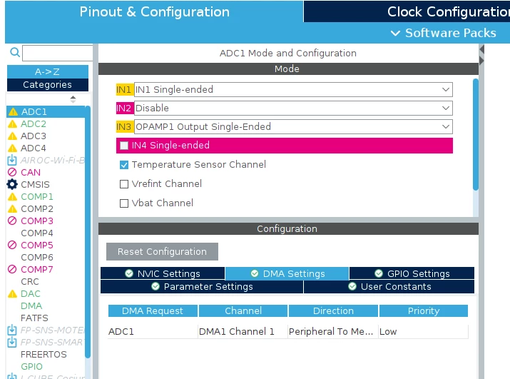

This is just the info/error : DMA impossible, because you didnt activate any peripherals to work with the DMA.
ie:
Select anything you want to work with DMA : SPI , ADC, I2S ... , set it to the mode you want, then you can add a DMA channel there.

I understand, however I would like to set up DMA for memory-to-memory mode, not from peripheral to memory or vice versa.

So try the memTomem ->
