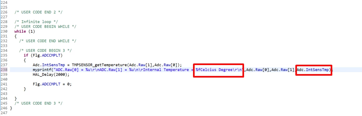

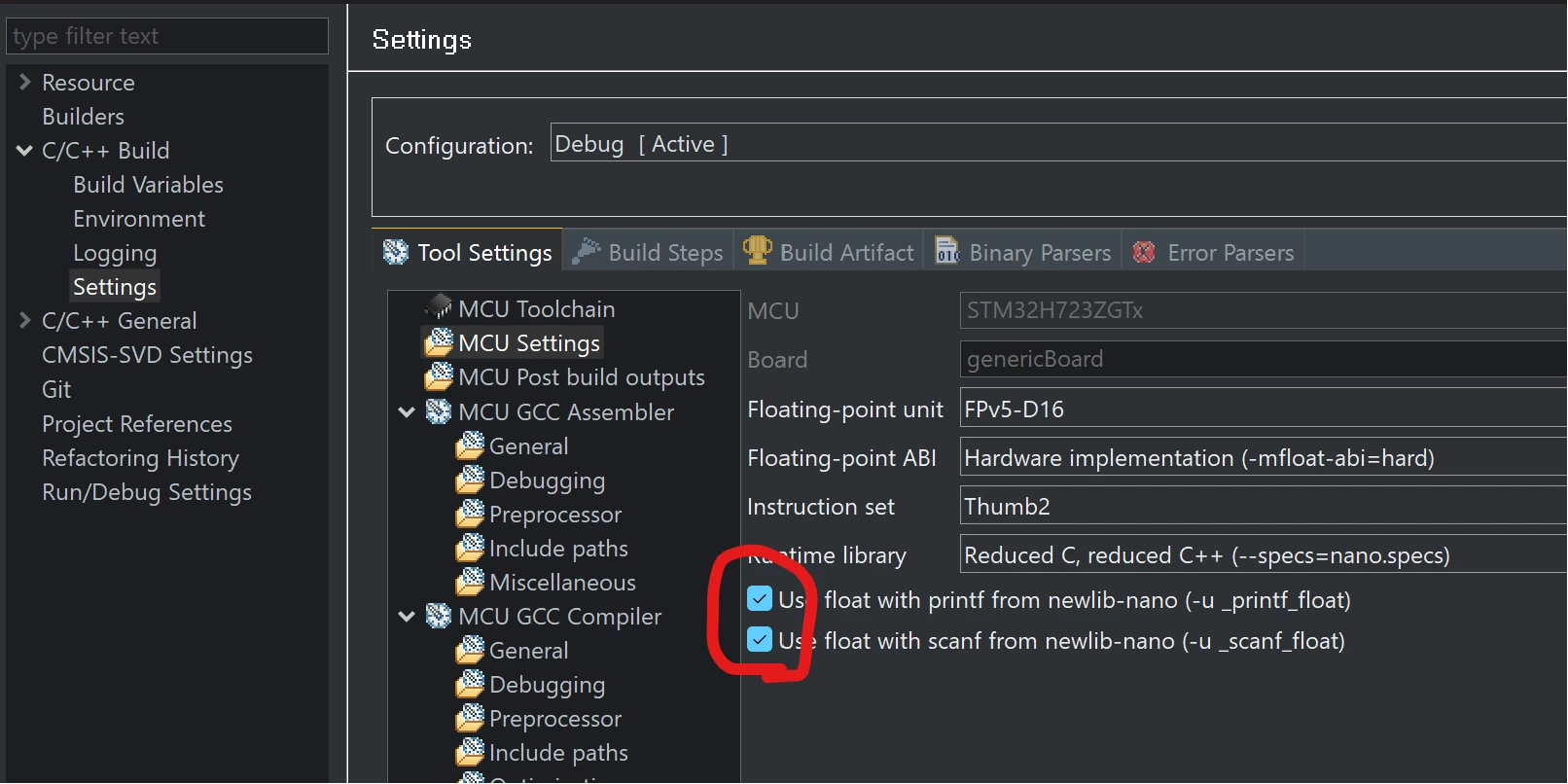

I cant display the value via UART.
  • February 18, 2024
  • 3 replies
  • 1329 views

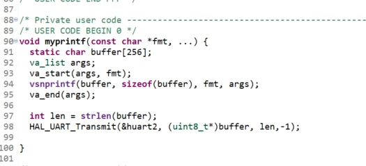

I wrote an application as below which prints formatted values. However, when I print the Adc.IntSensTmp, I dont see the value as expected. Instead, I see the output below. Could you pls help me resolve ?
Thanks.

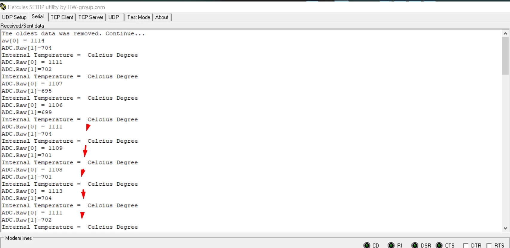

Here is the output I get.
    3 replies
    Tesla DeLorean
    Guru
    February 18, 2024
    Need to enable the floating point printf() libraries, or use dtoa()

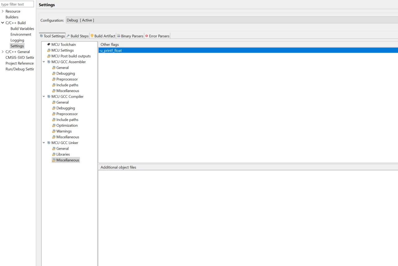

    I did it by enabling a flag as below.
    Project -- > properties --> C/C++ Build --> settings --> MCU GCC Linker --> Misc --> Other flags
    add -u_printf_float
    February 18, 2024
    There are dedicated checkboxes for this in STM32CubeIDE.
    The compiler also issues a warning about this if you have "%f" in a printf statement without those checkboxes enabled.
