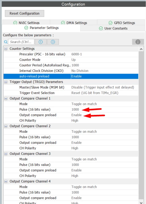

First of all, 4 LEDs blink at the same rate, no matter what values I provide in the interrupt callback function via __HAL_TIM_SET_COMPARE function. I can control the frequency of the signal generated via the counter clock, under configuration tab of the TIM4 mode and configuration on STM32 Cube IDE.
The frequency increases when I lower the prescaler.

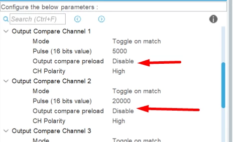

  4. I dont know what these parameters below (Pulse and Output Compare Preload) do exactly, could you please help me understand ?

Sorry for the confusion, I haven't thoroughly read your initial post and assumed you are using PWM mode of the channels set to Output Compare. Now I see you're using Toggle mode, and with that, the scheme you've described should work (provided the interrupts are handled fast enough).
However, you've set ARR (period) to 1000 and also all CCRx (Pulse) values to 1000 - so far so good, the interrupts happen when CNT reaches 1000 - but then you increase CCRx. If CCRx>ARR, the interrupt always happens when CNT reaches ARR, that's why you see the same period all the time.
You want ARR to be higher than the longest period, and the calculation in the interrupt should wrap the result around properly (i.e.
__HAL_TIM_SET_COMPARE(htim, TIM_CHANNEL_2,(ccr_content+pulse2_value) % (ARR_value + 1));
It is a good idea to leave ARR at its maximum, which for the 16-bit TIM4 is 65535.

Also, if you use CCRx preload, the value you write will get active only after the next Update. That is definitively not what you want here; so you don't want to use CCRx preload.

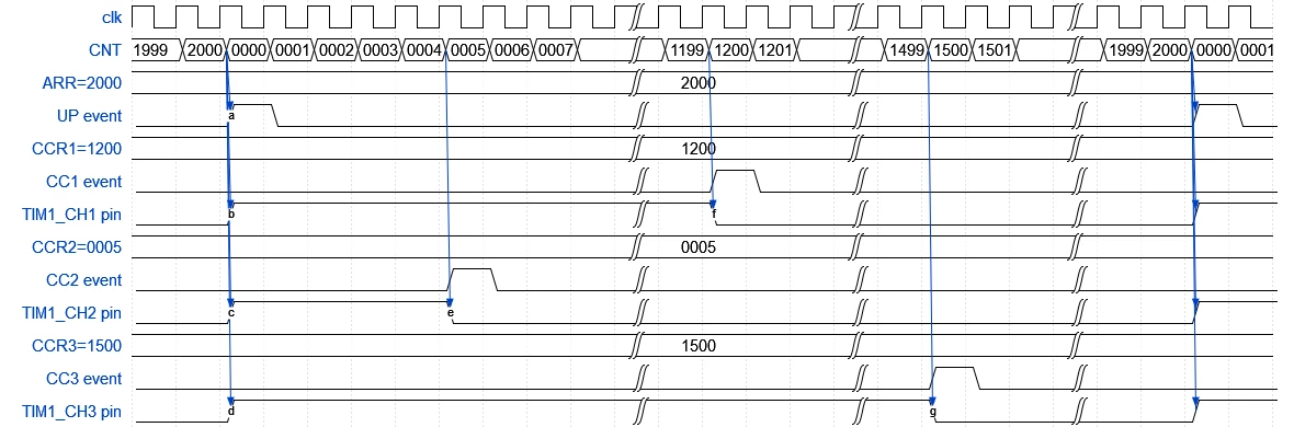

February 22, 2024
Maybe the following diagram helps you. There's only one counter (CNT), and so all PWMs (TIMx_CHx outputs) have the same frequency given by value in TIMx_ARR; they differ only in the duty cycle (pulse width), set in TIMx_CCRx:
(Drawn with https://wavedrom.com/editor.html ).

One point left open for me that is, what is the impact of Output Compare Preload field exactly?
When I enabled it, timer couldnt generate the expected signals.
waclawek.jan
February 24, 2024
If Preload is enabled, the value you write into TIMx_CCRx is not used immediately, but only after an Update (i.e. timer overflow) happens.
