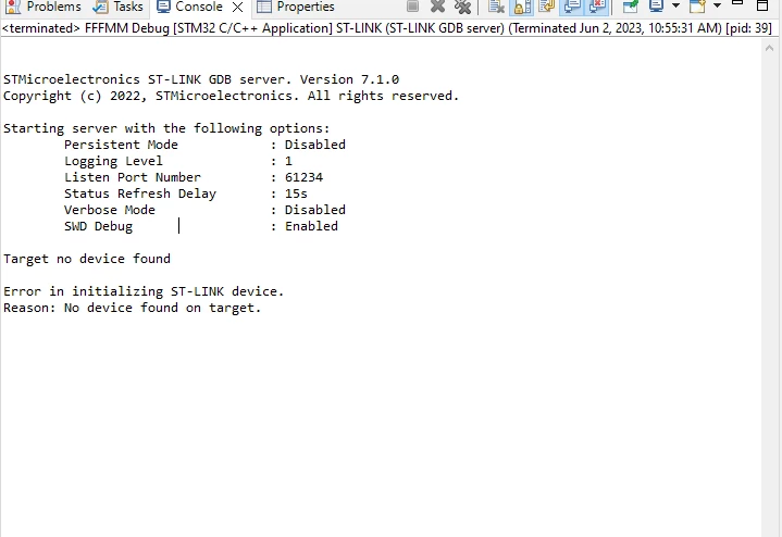

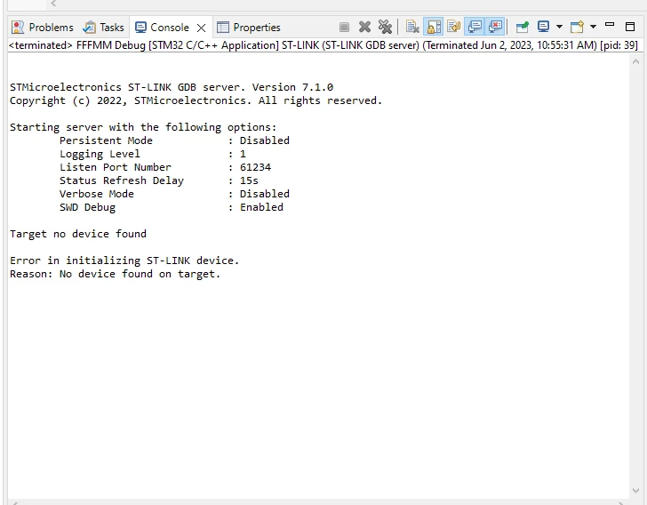

I cant able to connect my STM32G070RB with my IDE .?
When ever i am connecting my STM32G070RB with CubeIDE . when i start doing debuging it shows like there is no target connected ( i have attached a clear picture for your reference ). until a hour ago it was fine. i was working with the flash memory for write , store and read function. kindly help me out

Could you please provide the GDB server logs to further analyze the issue.

Custom board or NUCLEO?
Can you connect with STM32 Cube Programmer?
Try connect under reset settings or with BOOT0 High. If connects erase user code.
Any chance of short or electrical event?
