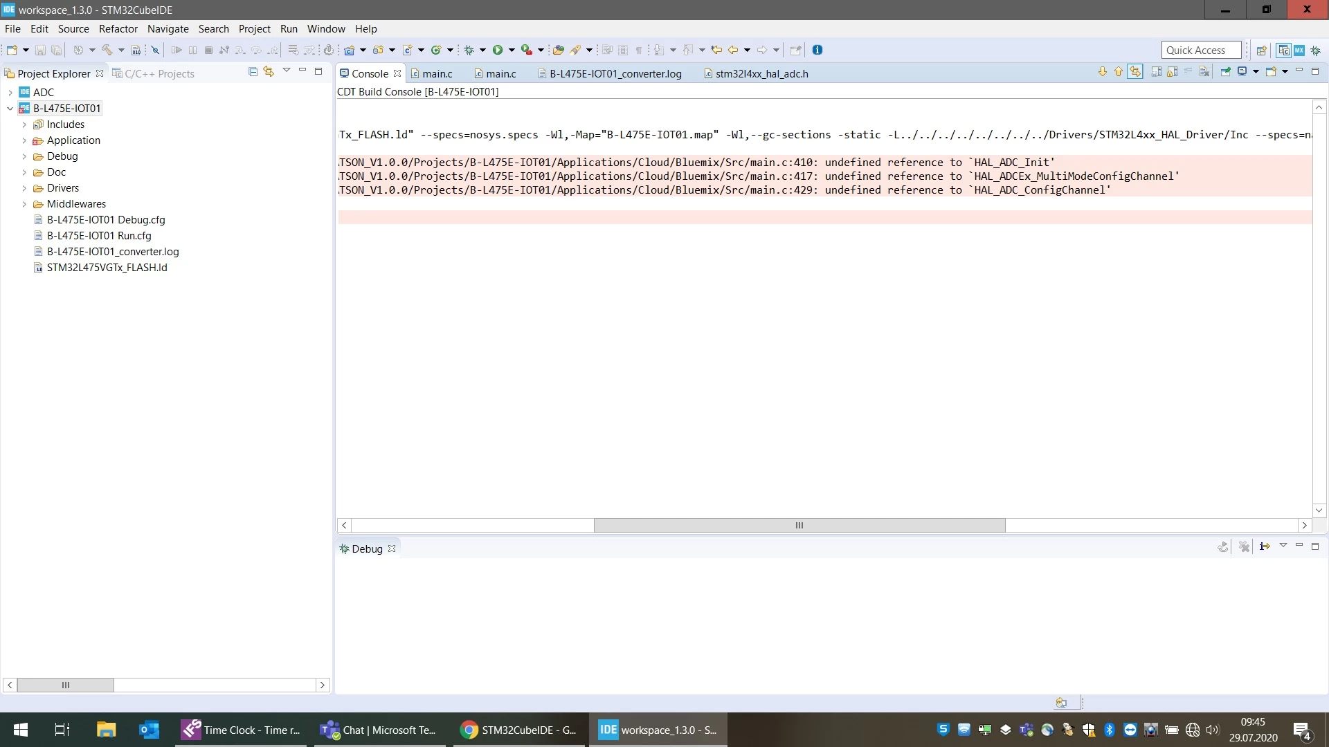

Hey there,

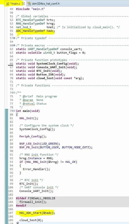

I tried to modify an existing project by using the ADC to measure a current. My problem is when I try to include the header stm32l4xx_hal_adc.h and use the functions like HAL_ADC_Start(); i will get the error undefined "reference to...". It's the same for every function declared in the header. The path for the header is added to the compiler. Some definitions from the header are recogniced only the functions aren't. Does anyone know how to solve this problem?
Thanks in advance.

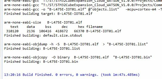

Best answer by Cartu38 OpenDev
Here are my steps leading to result ok from scratch
1) Import SW4STM32 project
2) Set defines (*_conf.h file is not local to project but part of the pack ... considering file system. In other words I've not a local copy ...)
3) Add source code to main.c
4) Add required .c files
5) Get compile success

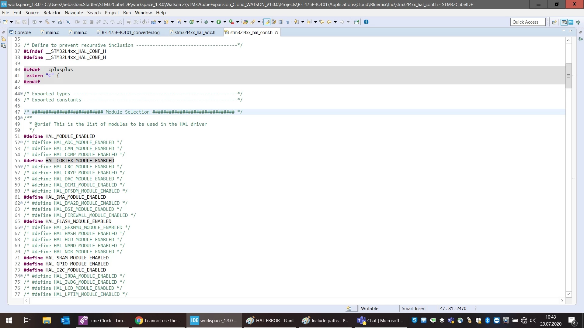

Check modules enabled in stm32l4xx_hal_conf.h

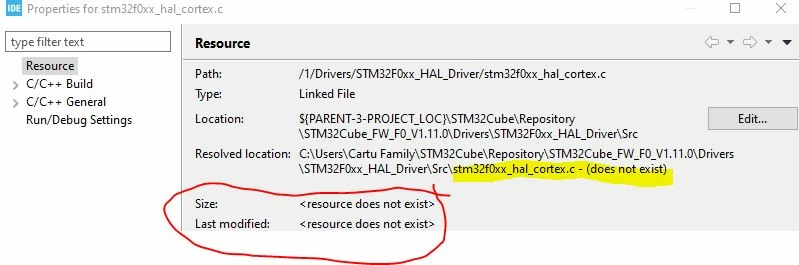

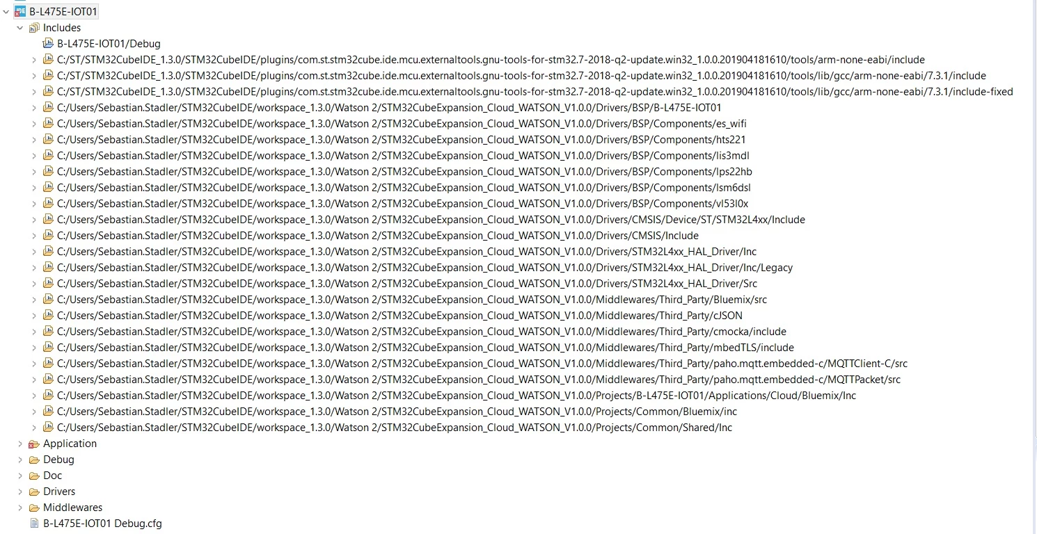

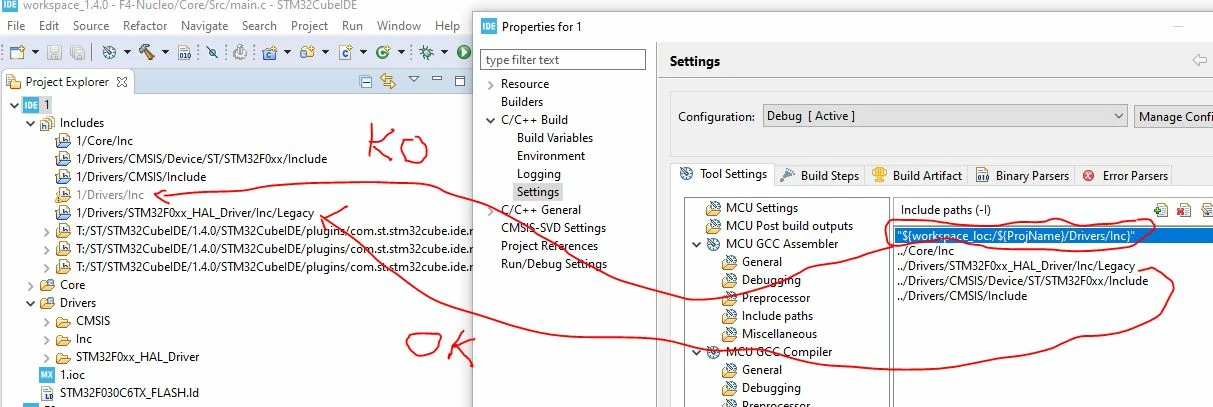

Include path definitionissue ? ... could be same as : https://community.st.com/s/question/0D53W00000DJpGPSA1/file-added-and-path-added-but-still-get-no-such-file
Takes care about your include coloring ... Is such include setup effective from Eclipse point of view already ? Please could you check if such line is leading to plain or grayed include like following snapshot ... if grayed means Eclipse not able to reach
Then if ok possibly some define to enable stuff as advised by @Community member​

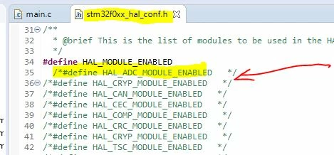

These kind of define to be uncommented in sync. with your IP(s) usage.
SStad.1
SStad.1Author
July 29, 2020

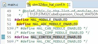

Cartu38 OpenDev
Graduate II
July 29, 2020
I guess so.
SStad.1
SStad.1Author
July 29, 2020
Still the same Error.

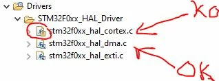

Could you x2 check your Drivers/STM32L4xx_HAL_Driver/Inc & Src content ?
Are .h/.c files here ? Are .h/.c files exist ?
Takes care to small icon overlay on files like ...

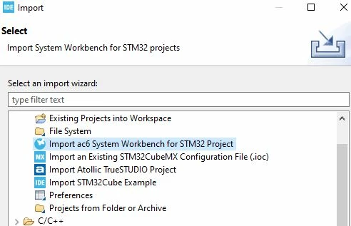

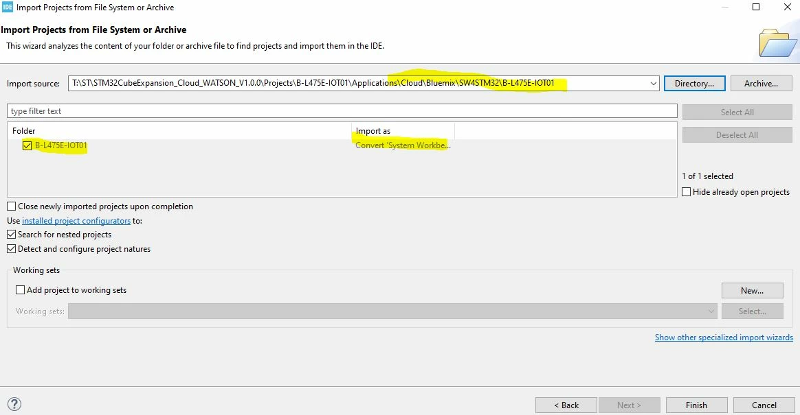

FYI proper import working model is:
SStad.1
SStad.1Author
July 29, 2020
Yes the project I'm starting with is an example from the IBM Watson expansion pack. It collects sensor data and sends the data to the IBM Cloud with MQTT protocol. There were different project files for Kei, EWARM and SW4STM32, the cube ide transformed the SW4STM32 project to the workspace when I first started it.

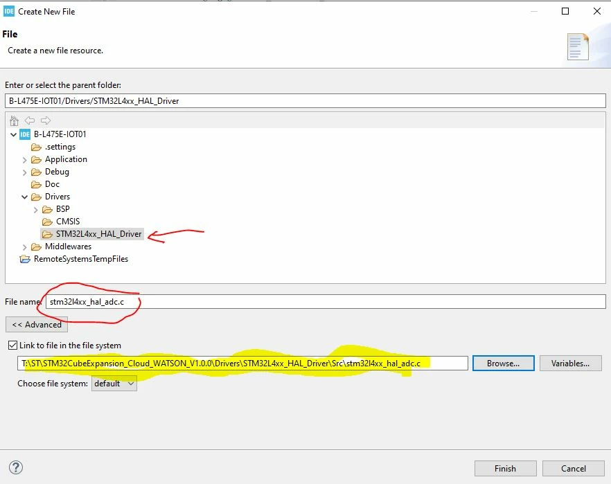

Solution is not .h but .c lack assuming you've rightly setup proper defines are shared previously. Setting reauired defines are taking care of .h include but still .c files are required from you.0693W000003BbSaQAK.jpg

I tried to start a new project, to make erverything right from the beginning. I uncommented the module in config.h and added stm32l4xx_hal_adc.c and stm32l4xx_hal_adc_ex.c as well. I included the header files in main.c and tried to initailize the ADC, now i have the same errors again.:grinning_face_with_sweat:
Cartu38 OpenDev
Graduate II
July 29, 2020
"start a new project" takes care due to such example packaging your primary sources may have been corrupted Thanks your first trials.
Be sure to delete your pack then expand it back from original .zip and have a new try.
