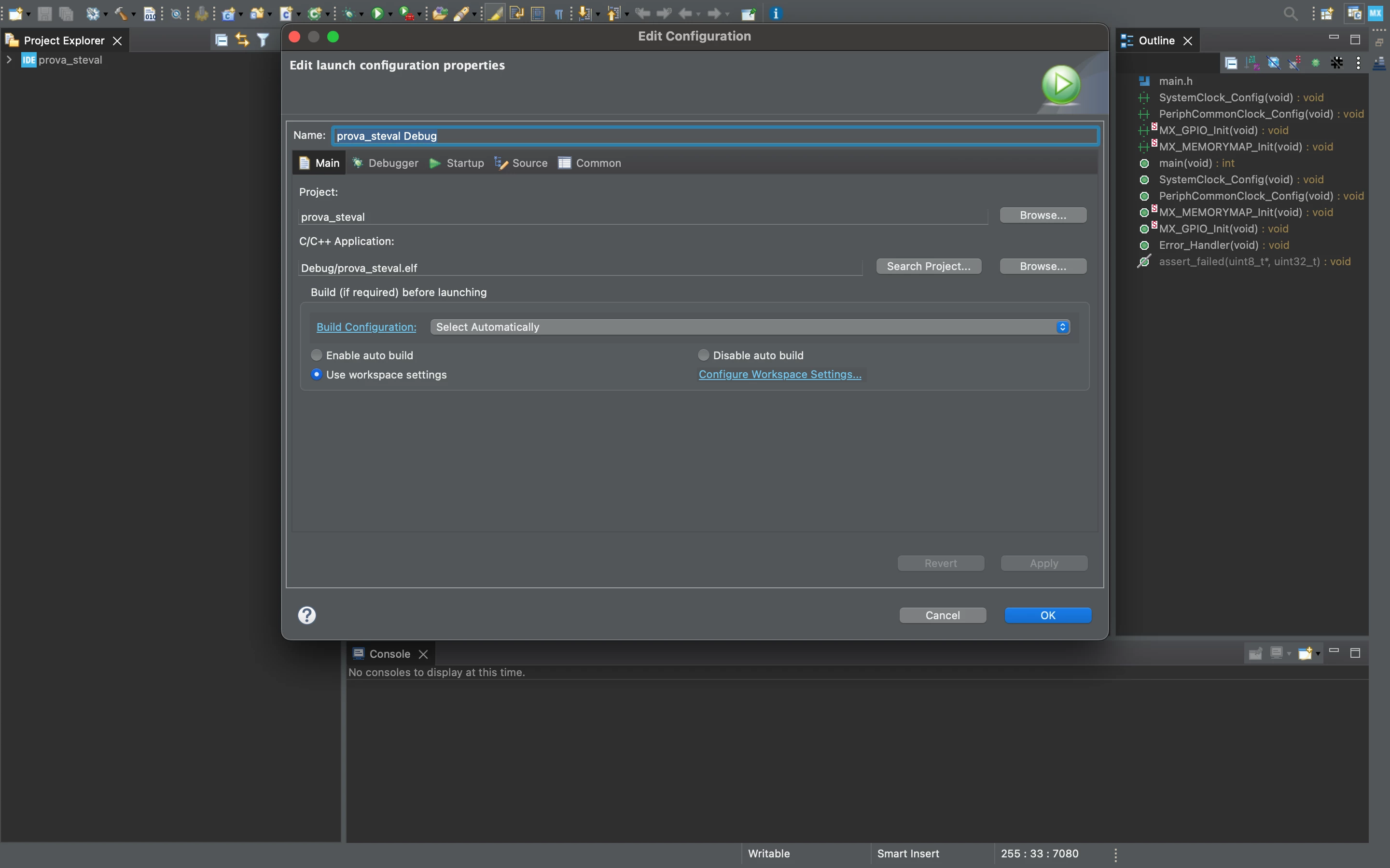

    First i've open my project (it's a simple blink code)

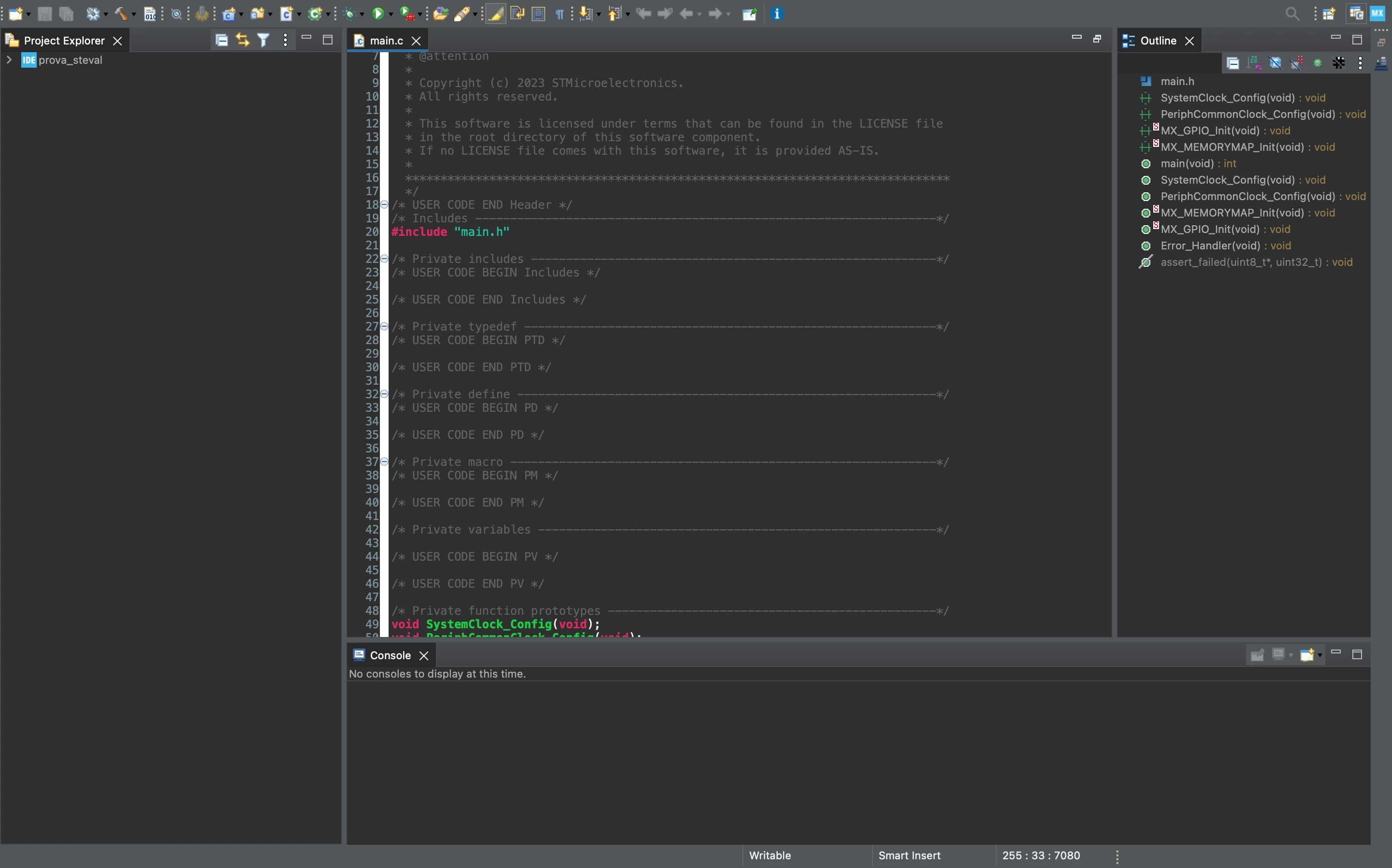

    Then i've opened the uploading interface

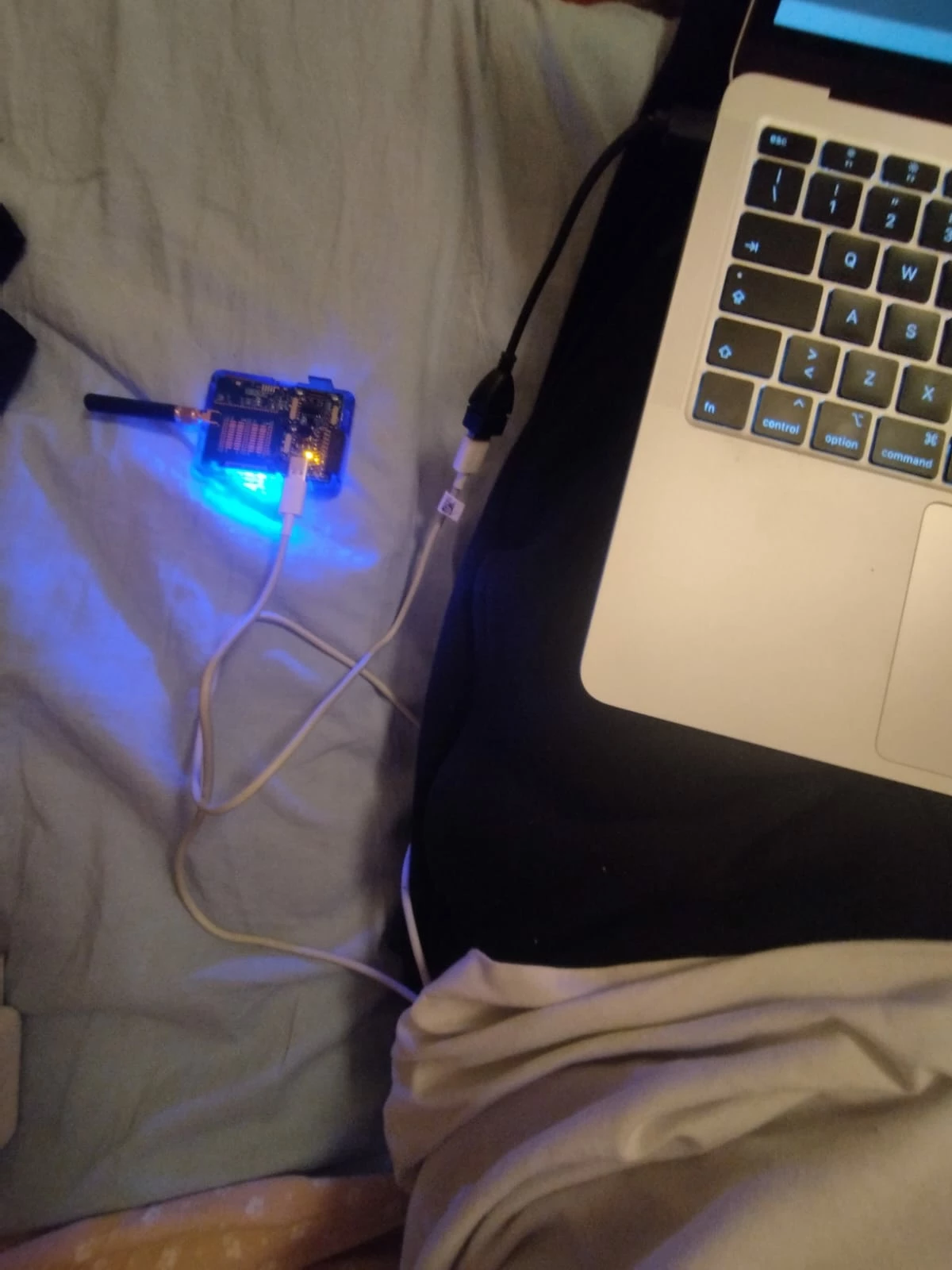

    I've plugged my steval board to my pc (using a random usb-c cable and a usb-a- usb-c adapter, because i've a macbook air and it have only usb-c plugs)

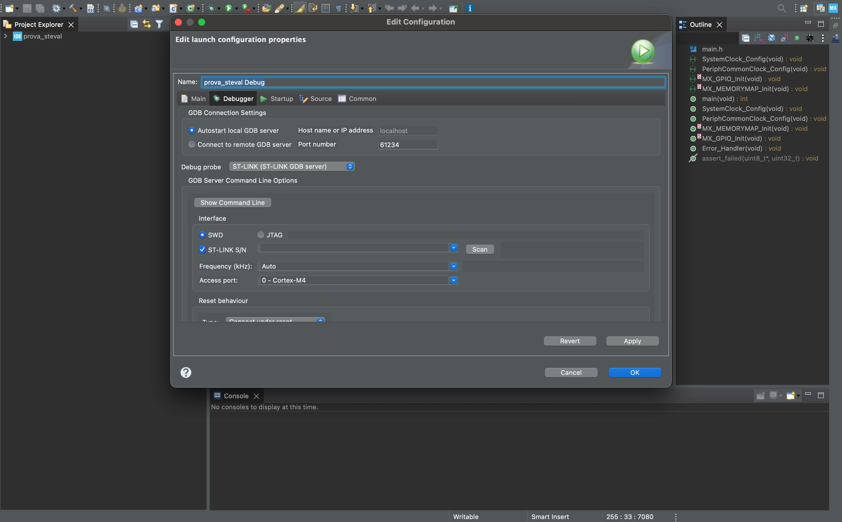

    at this point i've selected on interface st-link and clicked on scan But no value returned to me

    @Semer CHERNI  i wonder i've resolved.
    simply steval astra 1b doesn't has booloader so i have to buy a STLINK-V3MINIE
