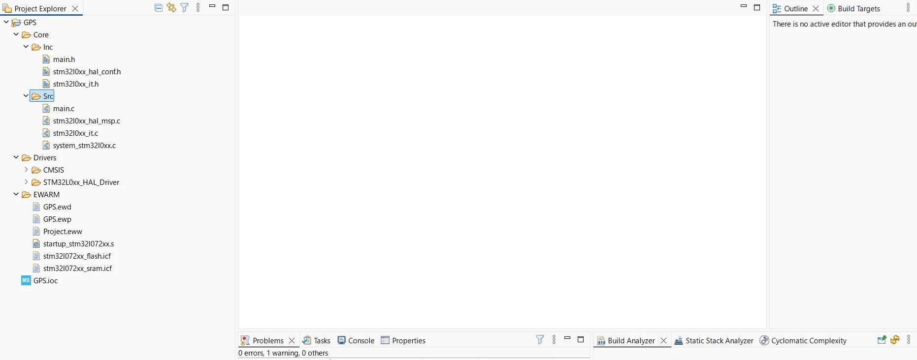

I made a project using CubeMX and imported it to CubeIDE. When I clicked Run → Debug, following message appeared, “The selection cannot be launched, and there are no recent launches.” I used CubeIDE version 1 before, and I could debug a program. What is wrong?

Looks like it was not imported properly and/or wasn’t created for STM32CubeIDE. Opening the “.project” file is typically the best way. Ensure you are generating code for STM32CubeIDE in the code generation settings.

As ​@TDK noted, maybe the “EWARM” folder is a clue that the code wasn’t generated for CubeIDE.

The problem was solved. I chose STMCubeIDE for “Toolchain/IDE”, generated code and imported to CubeIDE. Thank you very much.
