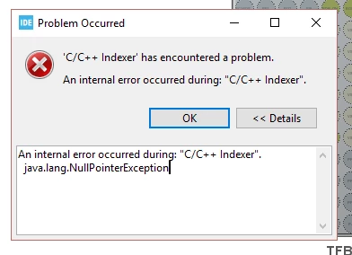

I can not open STM32 project that I created in CubeIDE on MacOS on Windows CubeIDE.
  • March 17, 2021
  • 3 replies
  • 1769 views
0693W000008xDDDQA2.pngIt says An internal error, screenshot's attached. I can attach you project itself.

Update! This project is opened without any problem on the latest version of Eclipse IDE for C/C++ Developers Version: Neon.3 Release (4.6.3) Build id: 20170314-1500.

You could also try to import by (ioc).
Mac and Win paths may differ at times.

@victagayun​ , as I mentioned above, project is opened on Eclipse (on Windows). And I'm sorry, I was not so detailed, project is not just .ioc, it is project with some bunch of code already.
