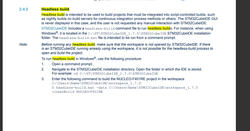

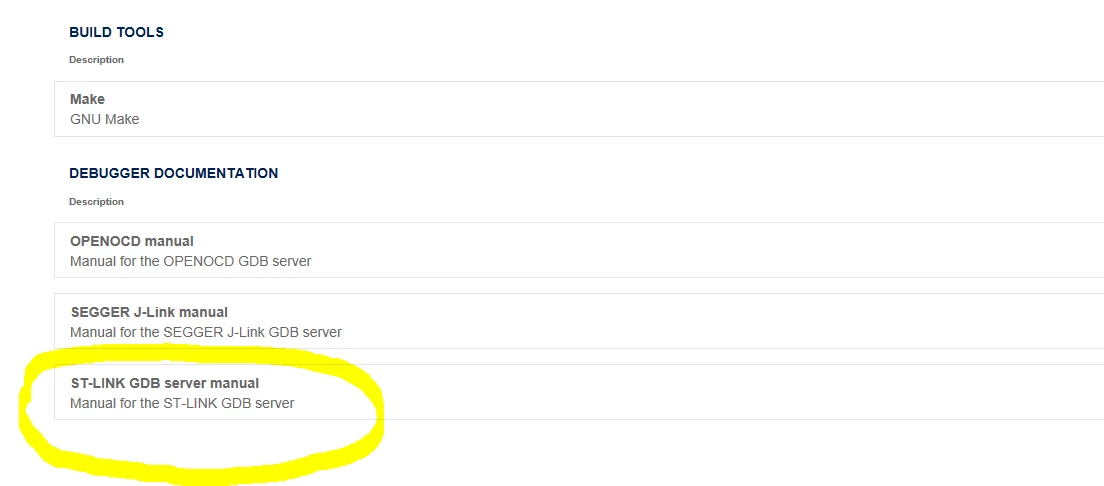

Wijeden RHIMI
January 5, 2023
Hello@VNaga.2,
  1. headless build : go to  help ->info center->2.4.3
  2. GDB server manual: go to help ->info center->STL_LINK GDB server manual
Maybe those two screenshots bellow could help you :
Don't hesitate to ask any additional questions .
