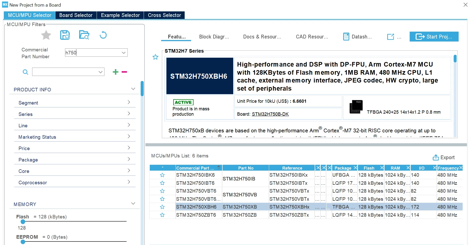

I am not getting Stm32H750 board in cube ide
I am new to cubeide can someone let me know how to add new board library to cube ide . Currently i am getting Stm32H753 but not Stm32H750

    Hello @DeepakY and welcome to the ST Community :smiling_face_with_smiling_eyes:.
    I suggest you update to the STM32CubeMX V6.11.0 (and CubeIDE V1.15;0) where you will be able to find all STM32H750xxx packages:
    STTwo32_1-1712388120053.png5

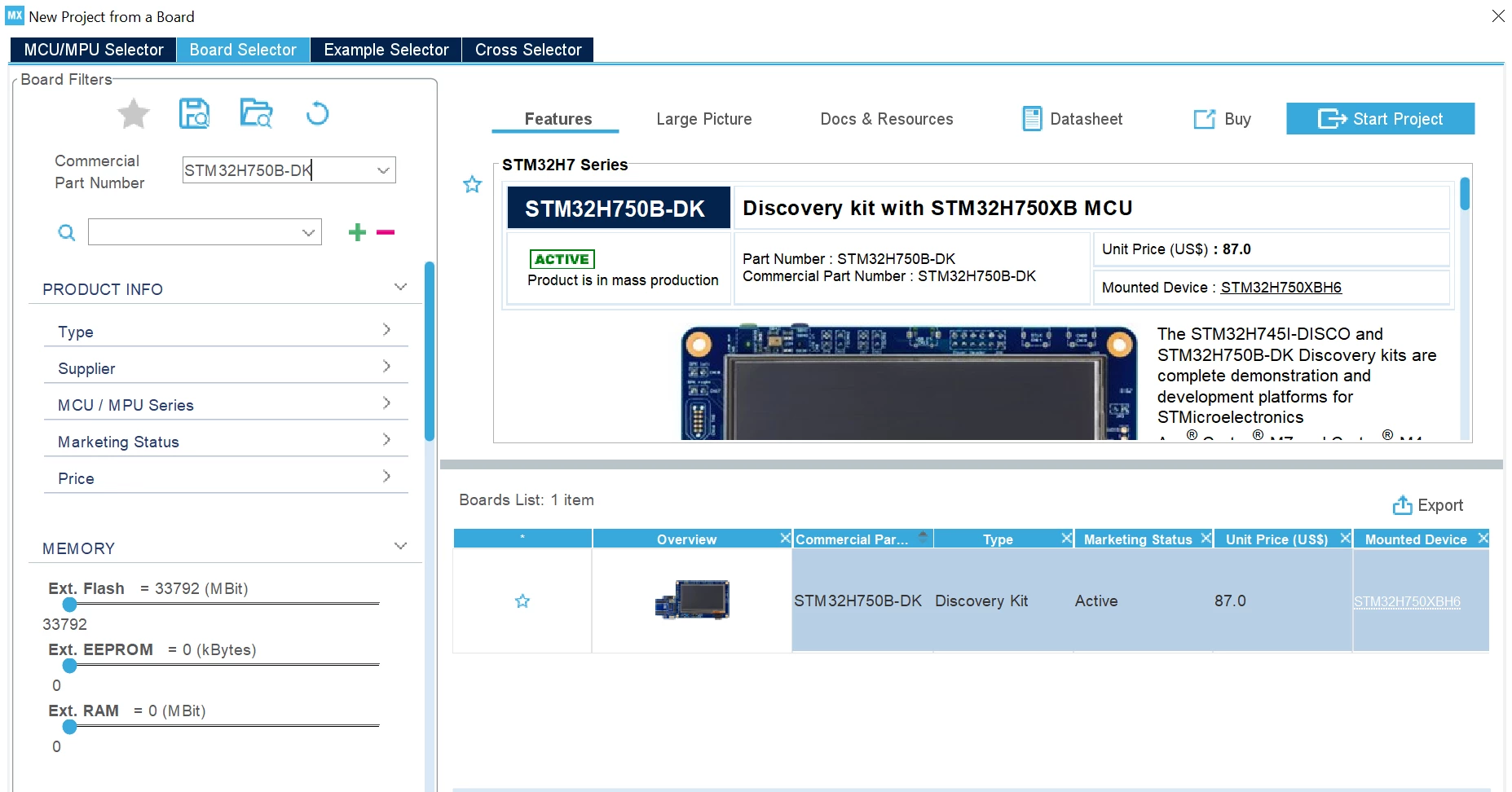

    And the STM32H750B-DK:
    Best Regards.

    mƎALLEm
    April 6, 2024
    Which version you’re using for CubeMx?
    Please use the latest version of CubeMx as it contains the updated list of the available STM32 on the market.
    Best Regards.
