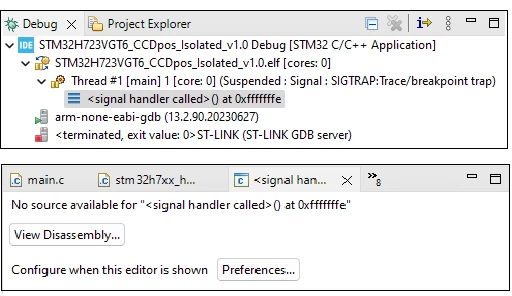

Hallo,
I needed more performance for my project, so I replaced my STM32F401 Blackpill by a WeAct STM32H723VGT6 board. I adapted my HW to accomodate the different layout of the H723 board and modified my application where needed because differences in various registers. When done I built my project with STM32CUBEIDE version 1.15.1 , upload it and tried to run it in Debug mode. I apply a simple 4wire ST-Link for the upload and debug communication.
Unfortunately, already in the second configuration statement I encounter an error, stating that a specific memory address cannot be read. I will try to give as much info as I can, hoping that more experienced members are able to conclude if this is a HW issue (just a bad part in the memory) or a SW error (just a case of bad code).
With trial and error I determined the exact statement that produces the error. The picture below shows the 'Debug' window and the window with the 'Disassembly' control.DebugError_H723VGT6_20240508.png
 The content of the 'Disassembly output' is shown here:

 The problem is caused by the statement '__HAL_FLASH_SET_LATENCY(FLatency);' which matches the statement I stepped into in my debug stepping. It struck me the error occurs just at a point where the latency of Flash access is checked after adjustment. Is just just a coincidence or an understandable reason for this error?
This problem is repeatable, which gives me the impression I face a HW error in the Flash memory. However, I'm not experiencend in MCU programming, so maybe I'm wrong. Can anyone shed some light??

    Hallo AScha.3,
    CUBEIDE doesn't let me modify the FLASH-WaitState, there is an asterix, poinnting to the statement "the setting is adjusted automatically when the Voltage-scale is set" (or something similar). I'm amazed about the relation, by trial and error I found the following relation:
        - Volt scale 0    3WS (4 CPU cycles)
        - Volt scale 1    0WS (1 CPU cycle)
        - Volt scale 2    0WS (1 CPU cycle)
        - Volt scale 3    0WS (1 CPU cycle)
    I tried a debug session with Volt scale 1: the previous error showed up again. Then, with setting 'Volt scale 0' => 3WS my problem looks to be solved. I got another error, now something with SPI, but not the repeating line 1139 of file 'stm32h7xx_hal_rcc.c' !
    About what you mention about the origin of the Board / MCU-chip: yes, you are right, this is the backside of buying cheap stuff.
    I also realize I should investigate how to set the number WS by writing the Register, to see if there is a more sophisticated solution.
    Thank you, SofLit and also Pavel.A for your willingness to help other people with their insight and knowledge. It is nice to know there are people around, willing to spend some time to help.

    AScha.3
    May 10, 2024
    how you made the project - with Cube/HAL ?
    Then you should get a warning, when setting something "impossible" .
    On H7 series you have to set core votage, flash waitstates, etc. according to core speed, you set in clock tree.
    (Cube doing this for you.)

    Hallo AScha.3,
    Thank you for your very quick response.
    Indeed, I use STM32CUBEIDE and HAL, certainly in the initial phase, because I'm not experienced in MCU programming. The error occurs in a CUBEIDE generated piece of code, but I'm aware this is no garantee for being without flaws. Also I don't understand how the code is intended to work, see the snippet below:
     /* Decreasing the number of wait states because of lower CPU frequency */
     if (FLatency < __HAL_FLASH_GET_LATENCY())
     /* Program the new number of wait states to the LATENCY bits in the FLASH_ACR register */
     /* Check that the new number of wait states is taken into account to access the Flash
     memory by reading the FLASH_ACR register */
     if (__HAL_FLASH_GET_LATENCY() != FLatency)
     return HAL_ERROR;
    In line 2 is checked if the 'FLASH_LATENCY' is > FLatency (which appears to be 0 !), so the 'TRUE-clause' is executed. There the 'FLASH_LATENCY' is adjusted to FLatency (=> 0), followed by a check on the readback of the adjusted 'FLASH_LATENCY'. This statement appears to fail, possibly by adjusting the Latency to 0 (????)
    I did a project-wide search for the declaration and assignment of the global 'FLatency' and could not find it. I don't understand how FLatency can be used without declaration. And a value of 0 may be the origin of the problem (???) I didn't dare to set it to another value to try, as I can't oversee the consequences.
    What do you think?
    Fred Schimmel

    Pavel A.
    May 10, 2024
    Looks like mismatch of core clock and selected voltage scale. Do not set the core clock to max. Begin with ~ 40 ...60 Mhz. Why voltage scale 2? If you would like remote assistance to start your board, here it is available.
    Note also that the newer generation of STM32H7 single cores (72/73, 7A/7B) have subtle differences from H743/75x, so use recipes for the older MCUs with caution.
