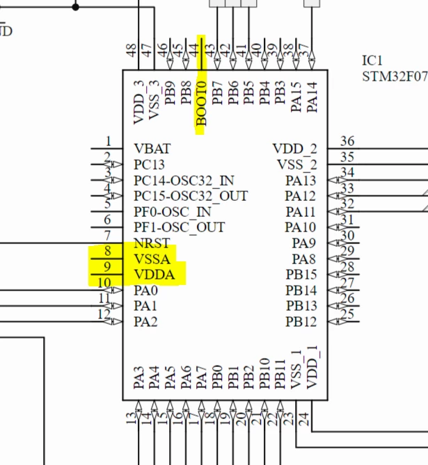

I have a problem with a clock configuration on my STM32F072C8T6. I need the 48MHz clock (HSI48) for the onboard USB communication. I have enabled this via ioc in the clock configuration. Everything looks fine there and no conflict is reported.
Now as soon as I load my program on the STM32, the debug connection breaks as soon as the following line is executed (in the automatically generated SystemClock_Config function --> see attachment) :

    Is this a custom board? How is the board being powered? Check NRST and VDD when it fails to help diagnose.

    Thank you for the answer. It is a custom board that provides a regulated 3.3V for the microcontroller.
    About the comments:
    - The 3.3V is stable and permanently present. It is exactly 3.3V.
    - The NRST behaves a bit more special. If I disconnect the NRST connection to my ST-Link programmer, I can continue debugging (again up to the mentioned line for the HSI48). However, if I connect my oscilloscope to this pin and want to measure the NRST, I can measure a square wave signal with period = 2.7ms and the ST-Link Programmer loses the connection to the microcontroller. This square wave voltage also occurs when I measure the NRST after said line has been executed.

    Okay, so it's resetting itself, probably on the line in question. I don't see why it would do that unless there's a power issue. Are you measuring VDD with a multimeter or an oscilloscope? A multimeter will not show a drop that could be the cause of the reset.
    Is this a genuine chip?
    Check the RCC->CSR flags on startup (and then clear them) to determine the cause of the reset, but probably not much to learn there.

    I could now test it in the lab and got the same result again (with my pricey lab power supply) . As soon as the CR2 register is written (any bits), the microcontroller goes into reset mode. So I checked the addressing of the CR2 register in the CMSIS files. The RCC register is addressed with 0x40021000, so it is correct according to the reference manual. The offset of the CR2 register is 0x34 according to the reference manual. If I now press the macro CR2 via the above described ways to get to the definition (finally in the stm32f072xb.h file), I am shown 5 different options how the CR2 offset is defined. I didn't quite figure it out in the corresponding file.

    Is there a way in your circuit to measure current drawn from 3.3V? 150mA should be plenty. Could be other errors on the board or in the schematic that are causing the issue.

    It could very well be a bug in the design, because I did my software development with the Nucleo-F072RB and everything worked there. Also, this is the first time I've worked with USB, so a mistake may have crept in.
    Attached is my schematic for the microcontroller / USB. Hopefully the comments in German do not disturb. :D

    All VDD/VSS pins need connected to 3V3/GND. Surprised it works at all.
    BOOT0 should generally be pulled down and not left floating.

    Thanks for the reply and the help, I didn't know that about BOOT0...I left that open on all previous designs.
    The oversight with the VSS/VDD pins is however quite embarrassing to me. I'm also surprised that the part works without it at all. Will correct that tomorrow and put wire jumpers.
    That can result in indeterminate start-up, depending on how supply rises, and perceived floating voltage in can boot your code or the ROM's
    The Analogue supplies are used for POR, PLL, crystals, etc not just ADC / DAC
