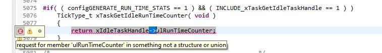

NCatt.1
November 8, 2022
I have followed the User guide for my existing project, but without the chapter 6.2.1.2 - Add to registry. When I try to compile I get an error in file tasks.c:
0693W00000WHlgpQAD.pngIs this error due to the fact I do not add queues and semaphores to registry or related to something else ?
Thanks for your help
