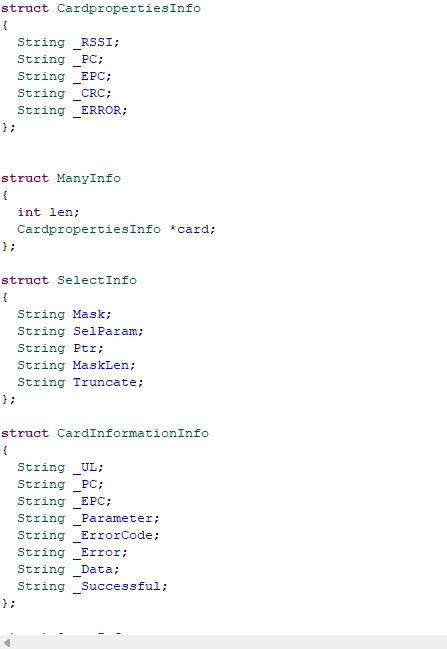

How to use the arduino string object in Cube IDE?
Do someone know how that we can import the Arduino string object in Cube IDE or how that i can make such object myself? I can't find any files about the construction of such object in arduino files(on my computer).
