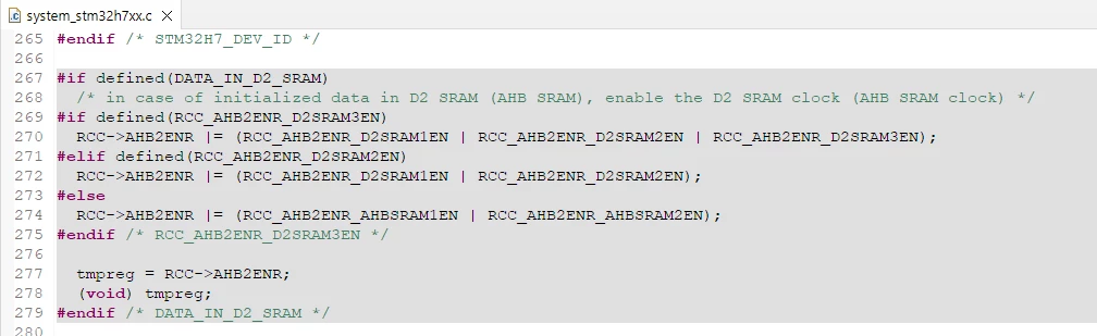

3. I observe that macro DATA_IN_D2_SRAM is disabled and hence concerned about how clocks to RAM_D1, RAM_D2 and RAM_D3 are being enabled. I am also unable to figure out any valid assignment to register AHB2ENR which would enable the clock to the three RAM sections.
In file system_stm32h7xx.c please refer to below section starting at line number 79.
The macro DATA_IN_D2_SRAM is disabled
/************************* Miscellaneous Configuration ************************/
/*!< Uncomment the following line if you need to use initialized data in D2 domain SRAM (AHB SRAM) */
/* #define DATA_IN_D2_SRAM */
Then from line number 267
#if defined(DATA_IN_D2_SRAM)
/* in case of initialized data in D2 SRAM (AHB SRAM), enable the D2 SRAM clock (AHB SRAM clock) */
#if defined(RCC_AHB2ENR_D2SRAM3EN)
RCC->AHB2ENR |= (RCC_AHB2ENR_D2SRAM1EN | RCC_AHB2ENR_D2SRAM2EN | RCC_AHB2ENR_D2SRAM3EN);
#elif defined(RCC_AHB2ENR_D2SRAM2EN)
RCC->AHB2ENR |= (RCC_AHB2ENR_D2SRAM1EN | RCC_AHB2ENR_D2SRAM2EN);
#else
RCC->AHB2ENR |= (RCC_AHB2ENR_AHBSRAM1EN | RCC_AHB2ENR_AHBSRAM2EN);
#endif /* RCC_AHB2ENR_D2SRAM3EN */
tmpreg = RCC->AHB2ENR;
(void) tmpreg;
#endif /* DATA_IN_D2_SRAM */

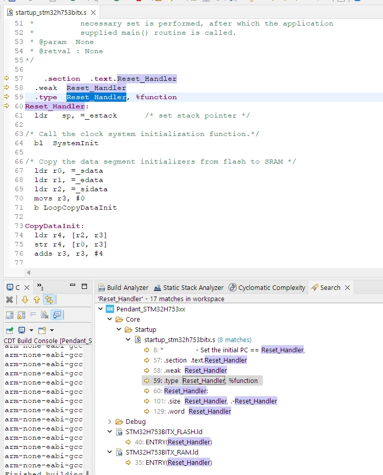

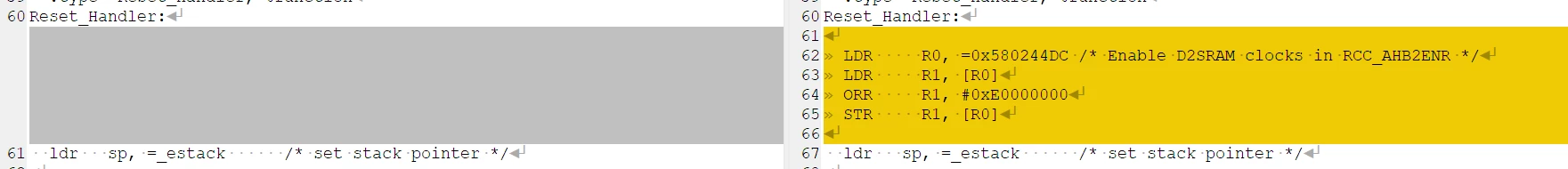

As you suggested I can either add code to file startup_stm32h753bitx.s (the one present on the right is the update):
Or alternately enable the macro DATA_IN_D2_SRAM present in file system_stm32h7xx.c (the one present on the right is the update):
I shall first try with updating the Code in above C file. If it does not work, then only I'll add the code to the above .S file.

I am compiling code using STM32CubeIDE and the code was generated using STM32CubeMX.
I only find below references for Reset_Handler. I do not find the line number 7 that is present in the snippet you shared. Which file should I look for the code snippet that you have shared?

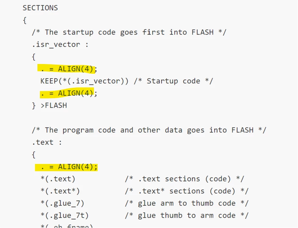

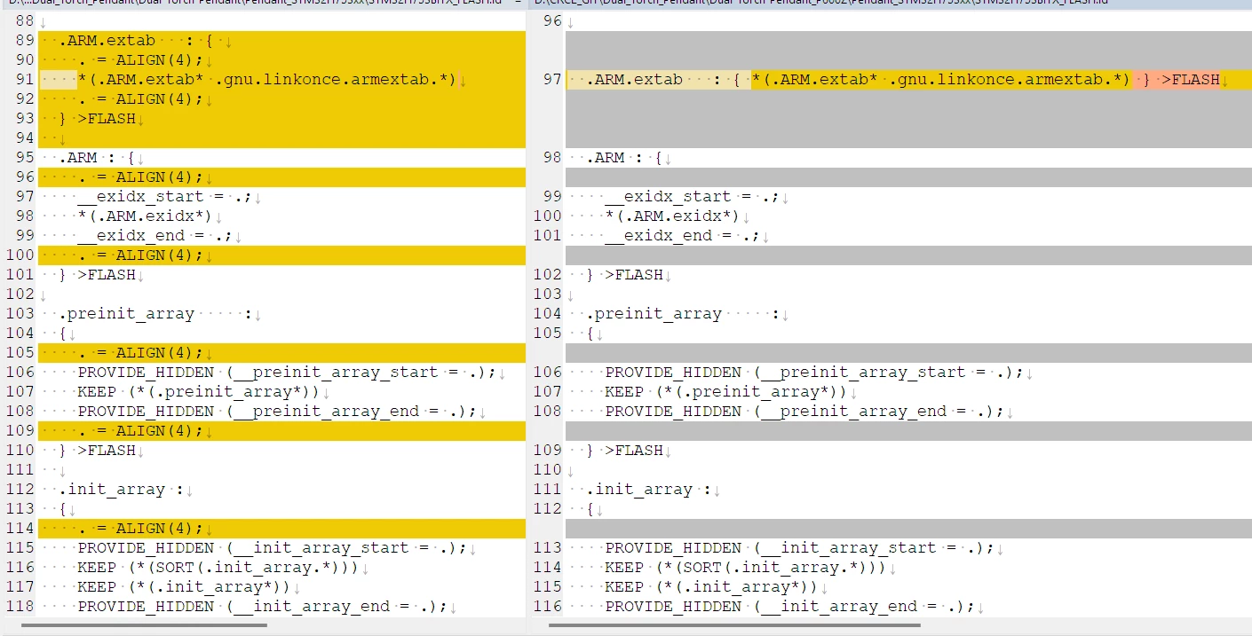

1 > Whether to add ALIGN(4) even inside the FLASH sections present ..
yes, in all sections.

Since answer to my first query is Yes, I believe the default STM32H753BITX_FLASH.ld file provided/added by ST should be updated to include the ALIGN(4) in all sections (especially in the FLASH sections). I would request ST / Khouloud (and her team) to update STM32CubeIDE so that the updated file is available when user generates the code.
The linker script already has alignment to 32-bit words.

I observe below when comparing the file that my team uses (on left) and the one that STM32CubeMX generated (on the right):
Regards,
Rajeev

https://community.st.com/t5/stm32-mcus-products/my-stm32h743vi-application-runs-to-a-debug-instruction-in-the/m-p/254664
; Reset handler
Reset_Handler PROC
 EXPORT Reset_Handler [WEAK]
 IMPORT SystemInit
 IMPORT __main
 LDR R0, =0x580244DC ; Enable D2SRAM clocks in RCC_AHB2ENR
 LDR R1, [R0]
 ORR R1, #0xE0000000
 STR R1, [R0]
 LDR R0, =SystemInit
 BLX R0
 LDR R0, =__main
 BX R0
 ENDP ; Reset_Handler

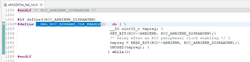

I believe to enable RAM_D1, RAM_D2 and RAM_D3 the following line of code should get executed:
However with DATA_IN_D2_SRAM undefined I am unaware of which piece of code (generated by STM32CubeIDE) is enabling the three RAM sections.

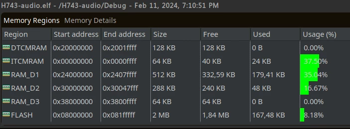

I use ITC for stack and heap, D2 for circular DMA (always running), D1 for all other:
February 12, 2024

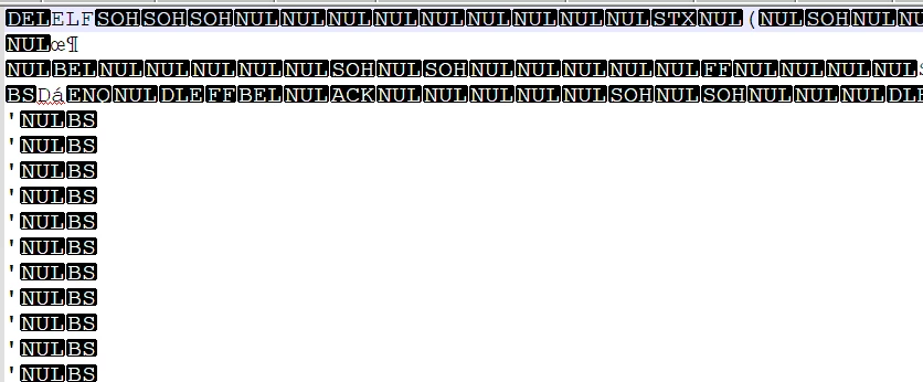

I tried looking in the ELF file, and I only observe below. I even tried searching with RAM_D1 but the search did not produce any result. Am I missing something in settings due to which I do not observe information similar to the snippet that you have shared?
Below is the snippet from the system_stm32h7xx.c file. The code part has a greyed background which means that the code part is disabled.
This means that even line number 270 is disabled (which is the code line that you have shared in your response).
Now if I try finding the macro (DATA_IN_D2_SRAM) used on line number 267 the macro is commented out.
Thus I am unable to understand which part of code (generated by STM32CubeMX and being compiled using STM32CubeIDE) is enabling the clocks to the RAM_D2 and RAM_D3 sections.
