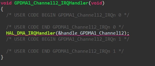

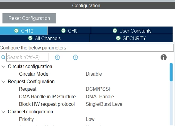

OV2640 is used as the camera module and I want to use GPDMA when I send DCMI data.
If MX sets up like this and generates code
There's an error like this (handle_GPDMA1_Channel12' undeclared (first use in this function); did you mean 'handle_GPDMA1_Channel0'?)
So please let me know how to use GPDMA in DCMI or OV2640, in STM32U5AZJ.

    Hello @achovy and welcome to the Community :),
    -->There's an error like this (handle_GPDMA1_Channel12' undeclared (first use in this function); did you mean 'handle_GPDMA1_Channel0'?)
    Thank you for bringing this issue to our attention with GPDMA: Standard Request Mode. I reported this internally.
    Could you please add in main.c under Private variables this line:
    DMA_HandleTypeDef handle_GPDMA1_Channel12;
    and in STM32u5xx_it.c under external variables this line:
    extern DMA_HandleTypeDef handle_GPDMA1_Channel12;

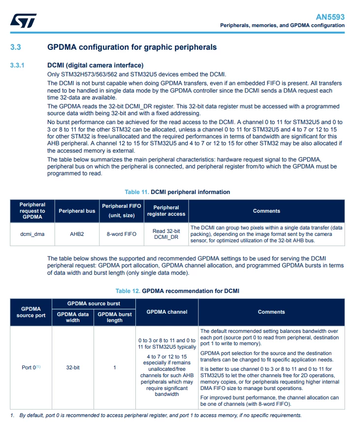

    Also you can use the GPDMA Linked-List mode without issue. For that I recommend you to refer to  the DCMI_ContinousCap_EmbeddedSynchMode example. This example can help you to start with GPDMA and DCMI.
    Also, please take a look at AN5593 How to use the GPDMA for STM32 MCUs precisely section GPDMA configuration for graphic peripherals.

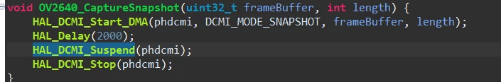

    achovyAuthor
    Apr 29, 2024 3:32 PM UTC
    Thank you for your advice.
    This function seems to run normally, but  I'm still having a hard time getting the image data.
    I'm attaching my code here.

    Apr 29, 2024 4:26 PM UTC
    Hi @achovy ,
    Glad to know that the initial issue is solved :).
    Could you please check the status of CAPTURE bit in DCMI_CR?
    I recommend you to take a look at AN5020 Introduction to digital camera interface (DCMI) for STM32 MCUs may help you. This application note gives to the STM32 users some basic concepts, with easy-to-understand explanations of the features, architecture, and configuration of the DCMI. It is supported by an extensive set of detailed examples.

    Jul 12, 2024 7:57 AM UTC
    Hello @achovy ,
    The issue is fixed in STM32CubeIDE1.16.0 and STM32Cube MX 6.12.0 versions.
    Thank you.
