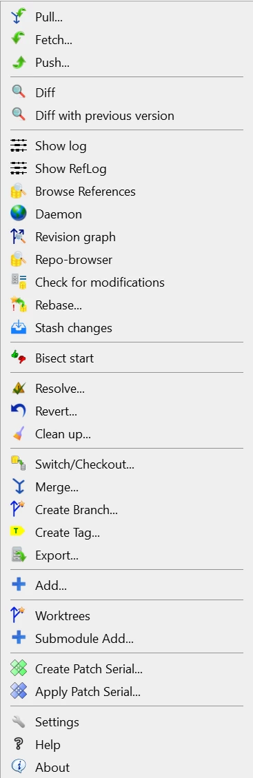

Karl Yamashita
Principal
October 14, 2024
You can either use a plugin in STM32CubeIDE by searching in the Eclipse Marketplace under the Help menu, or you can use a 3rd party Git interface. I like using TortoiseGit which you can use on other types of folders that are not an STM32 project. It has a lot of features
If a reply has proven helpful, click on Accept as Solution so that it'll show at top of the post.CAN Jammer an open source CAN bus hacking toolCANableV3 Open Source

Karl Yamashita
Principal
October 14, 2024
To make it clear, you can create a repository for each project. And each repository can be part of the Eclipse workspace. You can clone/branch individual projects.
However, if you make the Eclipse workspace a repository, when you want to clone only one project, you have no option but to clone all the projects from inside the workspace.
